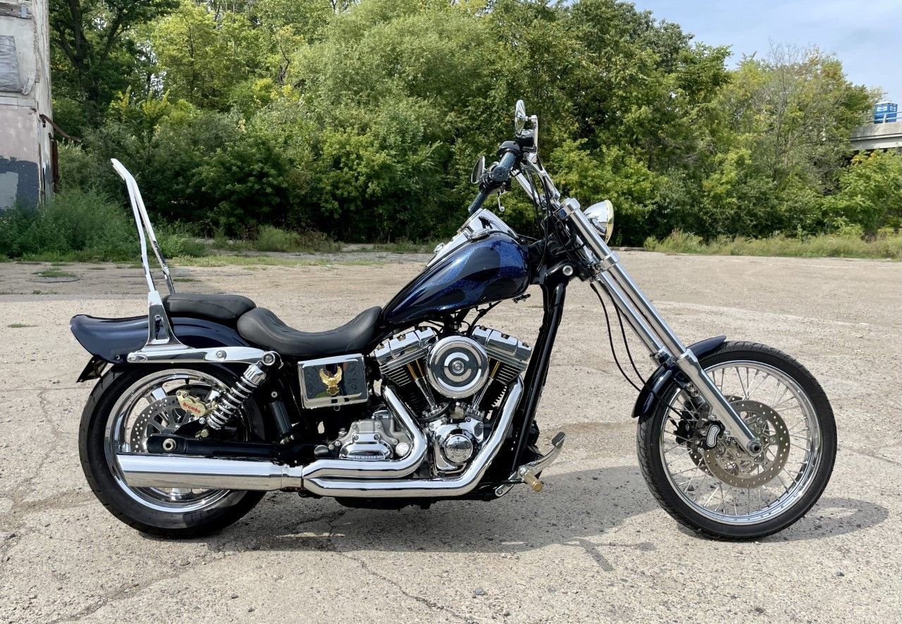

I went all brass everywhere. A few brass bolts for small things, but as others have mentioned, nothing requiring strength. For all engine bolts I used brass bolts covers made from bullet cases.
More pics: https://www.hdforums.com/forum/2018-...l#post17663384
