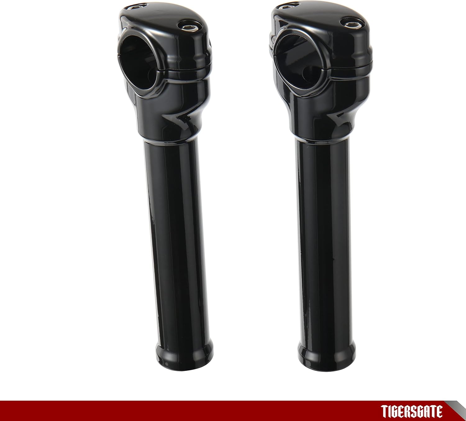

Wondering if anyone has tried Ebay or Amazon risers. There are a ton of options that are much cheaper than fancy brands. Reasons I'm curious are below:
1. I want some apes eventually ($1k or more) but not willing to blow tons of money initially until I find the right height, width, pullback, etc.
2. Like the idea of riser swap since I can test 2, 4, or more inches without the bar hassle (tear down bike)
3. Fancy brands (USA) charge at least 300-500 for just risers. Seem way overpriced.
4. There are no reviews on these chinese brands. There are tons of sellers but no one tried them yet?
5. Will they really snap off and kill me or work properly?
The risers I'm considering are 8" and clamp on stock 1.25 bars. Easy swap. If I don't like them, oh well, they were only 90 bucks.
Bike is 2017 Wide Glide. I already have 2" spacers on stock risers. Need more height since my back isn't happy.
Is it worth the chance for supporting the commies?

Will they snap off or break off causing you to crash? NO
WILL they allow you to try different setups cheap to find what you are looking for? YES
Having said that:
- They WILL most likely not be a nice with fit and finish.
- Some of the "black" finishes end up looking purpleish over time.
- Bolts will be lower grade Home Depot type and could rust and strip the hex heads.
I tend to shy away from the cheap Ebay stuff for the above reasons. There is an old saying "Good, Fast, Cheap . . . you only get to pick two"
If money is a concern I would try to find used name brands on Ebay, Facebook, here in the classifieds, etc. Many guys go through different setups until they settle and you can find used risers and bars heavily discounted some never mounted.
Good luck!

China short ones maybe but a tall set like that, no way.
Problems with china stuff like that is the materials they use is **** poor particularity pot metal castings, caps will deform over very little time allowing the bars to move and you will strip the threads out trying to tighten them enough, their tapping clearances are generous so the threaded holes tend to be sloppy fits and the hardware that comes with are not any better. I've had to helicoil a few sets of them and took material off the clamp caps to get them to cinch down, bars would still move after time, owners eventually tossed them for US made.
