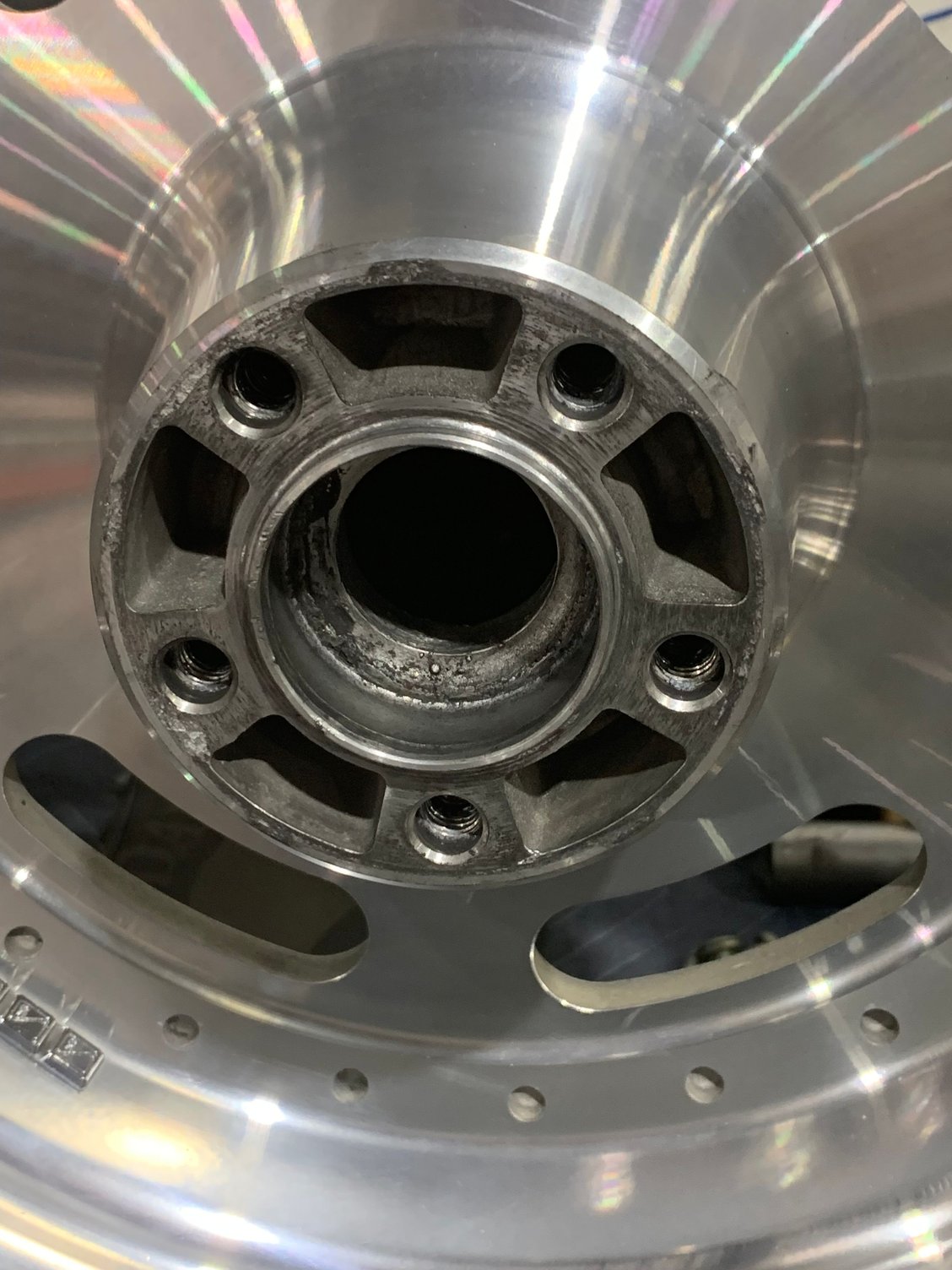

Could be. I blew out a rear wheel bearing on a ride on time. I was near the big deal Harley Indy in town and they were open on Sunday. Lucky right?
After getting the rear bearings replaced, I noticed the occasional squeak/squeal but it was so intermittent I wasn't sure if it was the rear wheel or not. About a year later, time came to change the tire and I found out the jerkoff 'master technician' over torqued the axle nut which actually cracked the bearing case and toasted the wheel...
