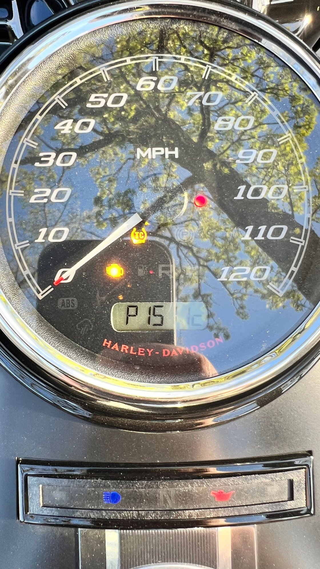

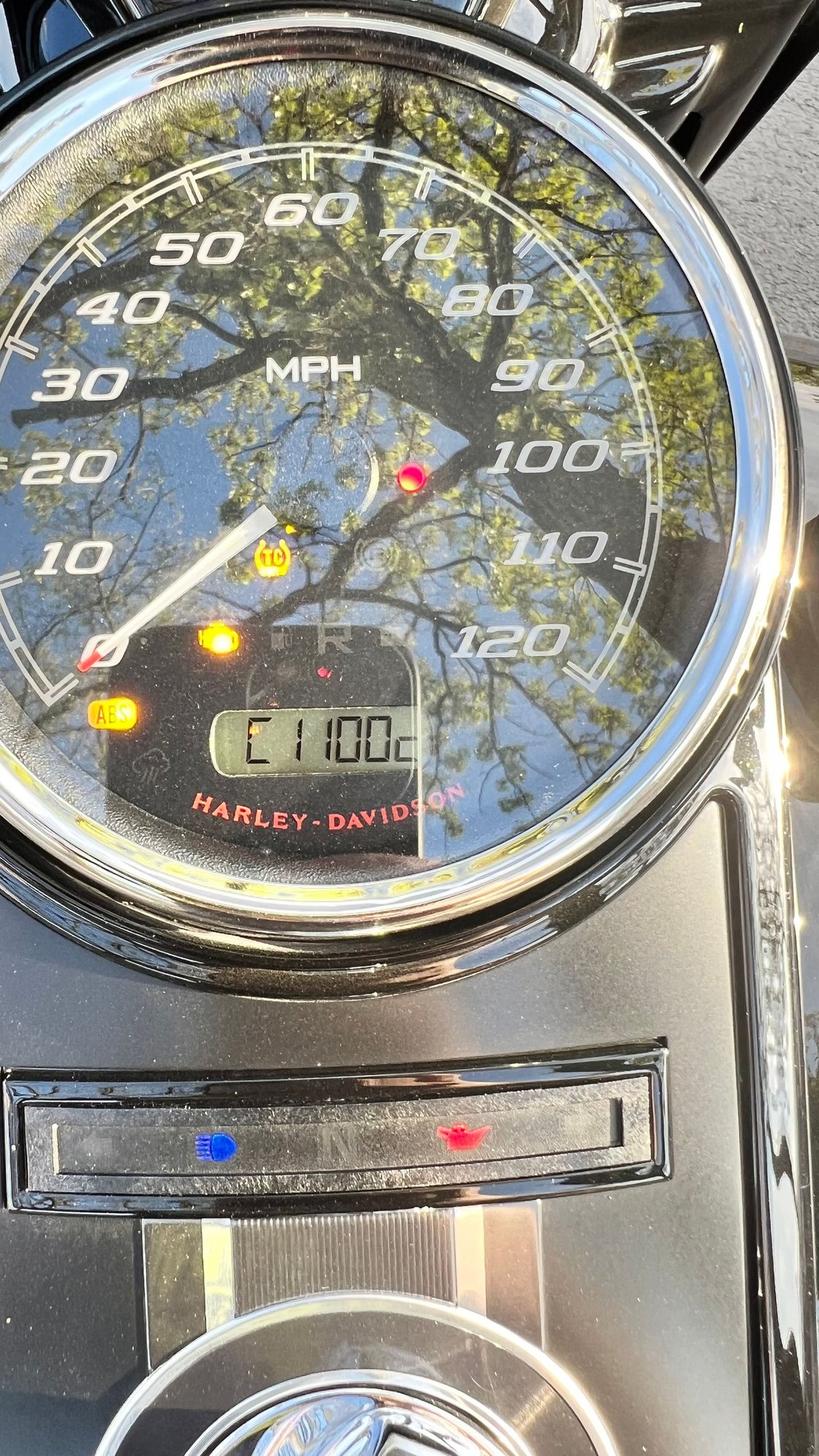

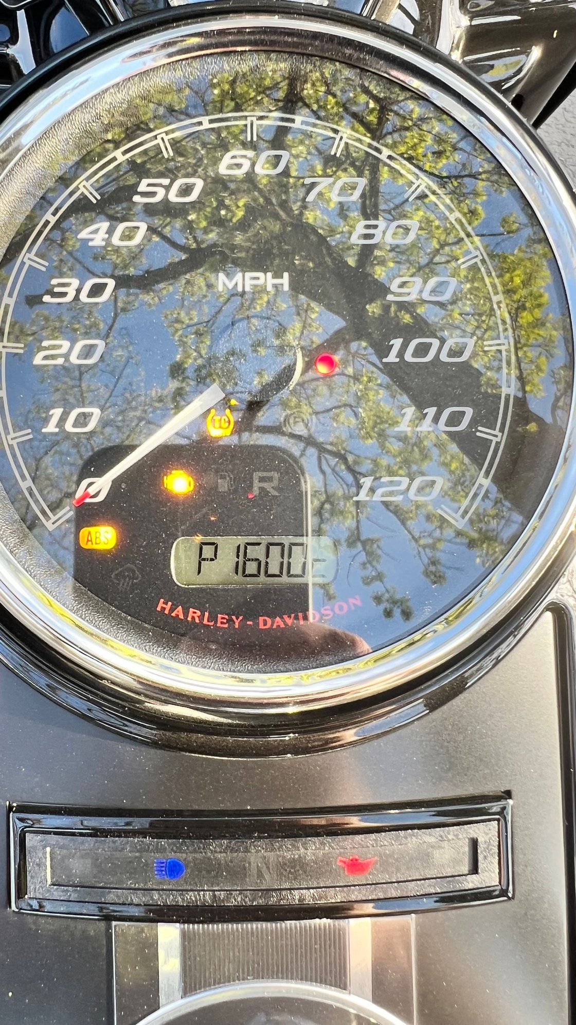

Hi everyone
Can someone please help me out here.
I recently removed my air filter as I did external vent mode but drilling the hole and running wire through backplate. After that I took a bike for a ride and some codes came in after check engine lit up these were mainly due to low battery so I thought no big deal. Today I took a bike for short ride again and as of now bike runs OK no issue no check engine light is on but ai decided to check if any new codes appeared and sure they did. Below is few shots any help would be appreciated.

Doesn't sound like you cleared from previous run. I would clear all of them and see what reappears. If there is no light, their not new.

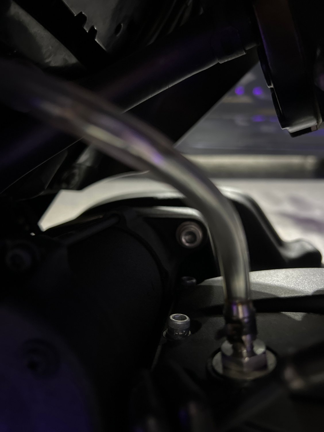

Yes I did external vent from trans. From the moment I did that I actually installed clear hose to see if anything is coming out of this trans vent and there is zero residue so seems like for some reason my bike still preferred to puke some oil through heads for some reason.

Below is picture from my trans vent hose clean like a whistle 🤷‍♂️

It is clean because it is not working like you had hoped. Either your "check valve" is not opening or is preventing any vapor from escaping, or you put the fitting in the wrong place, or...?
All codes shown are current which indicated by "C" suffix, for "not new" codes they'd be historical with "h" suffix.
All the "P" codes are related to EFI - did you disconnect anything when you had your backplate off
P2100 - EFI TCA Motor Circuit Open
P1600 - EFI Module Processor internal error / watchdog error
P1511 - EFI power management mode
I'd remove that backplate again and check connectors.
I didn't disconnect anything while removing the backplate. I found one post indicating same codes due to low battery voltage. Hope this is what happened here but want to ride it some more to see if any check engine light will pop out. Is it possible that code will pop out without engine light coming on?
Hmm this is video where I captured what I did on this vent.I just check this valve and it is operating properly by allowing air to go up the hose when a bit of air pressure is applied so it is not the valve. Wonder if you see any potential issues with my set up based on my video.
Why ride it some more if you already have codes ? Battery is an easy check, however you have 22, kind of too early for battery to fail. Check terminal connections, grounds.
