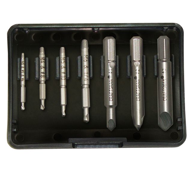

Originally Posted by golfblues
I would try the dremel & cut a slot in the head or use an easy out bit. With the counter sunk head if you drill the head off there will be nothing left to grab it with.
Now that I looked at the pics again,I think Golf may be right about nothing to grab on to.
The only problem is if the screw does not unscrew,the Sears tool will just cut the head off.
