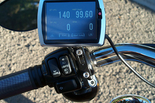

Originally Posted by stro1965
I did that, thank you, I'm trying to figure out the relationship to tuning a bike. Can you explain it in laymans terms and actually be helpful?
Here you can see KPa is used to display Manifold Air Pressure (MAP).
MAP is a measure of the pressure within your intake manifold. For our engines, it usually goes from 0 to -14.7 PSI...this means that normally there is a vacuum in the intake manifold. This makes sense since an engine is nothing more than a giant air pump...pulling air in from one side (intake) and pushing it out the other (exhaust).
In tuning, MAP coupled with RPM and Throttle Position (TP) will give us an indication of the load conditions being placed on an engine. Note that the closer you are to idle, the more vacuum you'll have in the engine. The closer you are to WOT, the closer the engine will be to 0 PSI...which is basically saying the pressure of the air inside the intake manifold is the same as the pressure of the air outside the engine.
Now right now I'm REAL foggy on data as far as how the KPa number changes as vacuum pressure changes (don't remember how they convert it...in the picture above the engine is not running thus the MAP reading should be 0 PSI...perhaps 100 KPa = 0 PSI??? Too lazy to look it up at the moment) but basically a change in TP does not necessarily equal the same change in MAP PSI. For instance, going up a hill...you may give it more throttle but because the engine is not increasing RPM at all (We're prettending you're just trying to maintain speed up a hill here) the change in MAP PSI won't be the same as though you were accelerating on flat ground with that same Throttle Position.
If I had one of my scan logs with me you could see how the MAP KPa changes with different RPM and TP variables.
