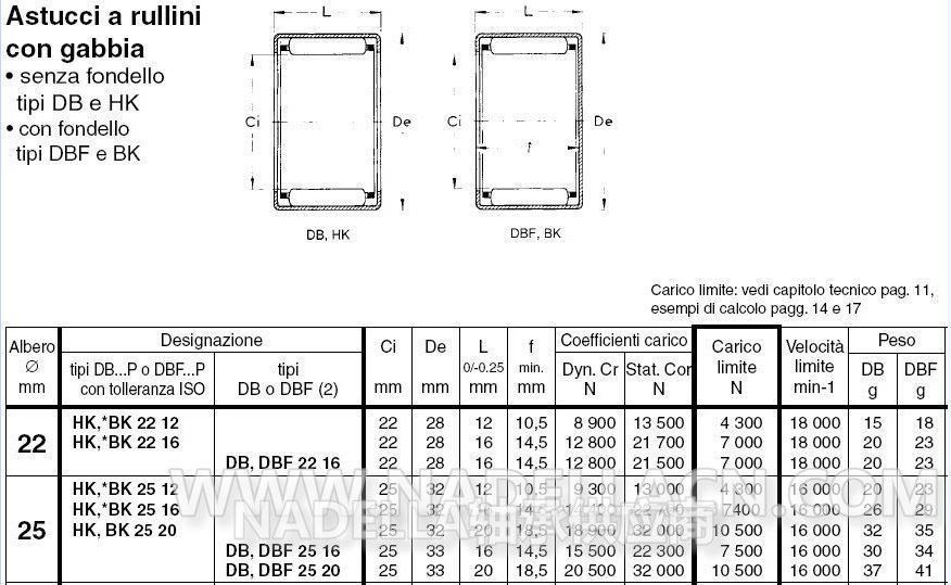

I have an '80 FLT. One of the bearings in the front wheel is a needle bearing which in itself isn't a big deal, but finding one to replace it is. Other than being use specific, maybe someone can tell me what issues (if using a bearing that is 1mm difference) could arise. Would it be a problem or not? This is a picture of the cross reference. I'm looking at using an HK2520 instead of a DB2520. All specs are identical except one.

The 1mm is on the diameter, it would be a sloppy fit in the hub. That is a Harley 9116 bearing. Looks to be still available.

Yes the 9116 is still available @ $53 each. They've discontinued the other bearing so have had to cross reference it to the 204PP4 FAF bearing. I wasn't certain though if that 1mm difference would make it less difficult to drive in or simply loose. I'm also looking to the future for when this is no longer available.

@GRBrown - The DB2520 was found by Berry Bearing here @ $30 each in Maine, but said that it wasn't a run-o-the-mill bearing. That is why I started looking myself. The DB2520 doesn't specifically cross reference on any of the data sheets I've found which is why I was looking to specs.. I only stumbled upon the HK2520 which won't work. I found the NK25/20 which is a ground shell with oil hole instead of a drawn shell, and now lt1 just found a TA2520. And in reference to the SKF 465966 ball bearing; it isn't a "standard industry" bearing either. One side is enclosed where the other is open. I've done a fair amount of research on these and while a flippant attitude towards your bike may be fine, this one requires a little more work.
