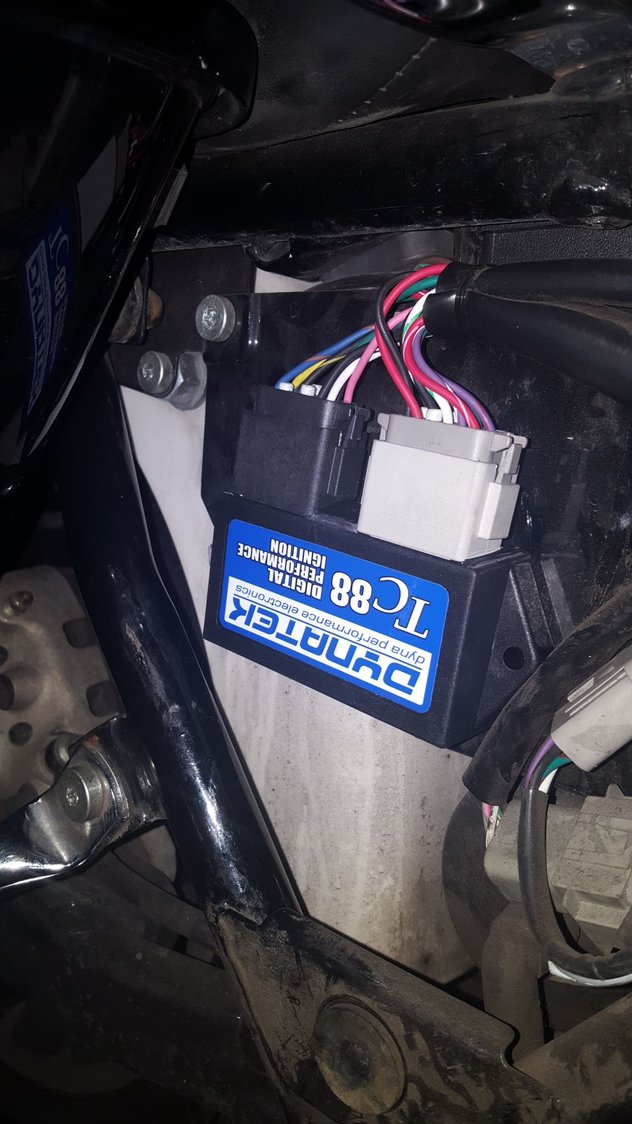

Gonna try the Dynatek ignition... only $75 on ebay.
