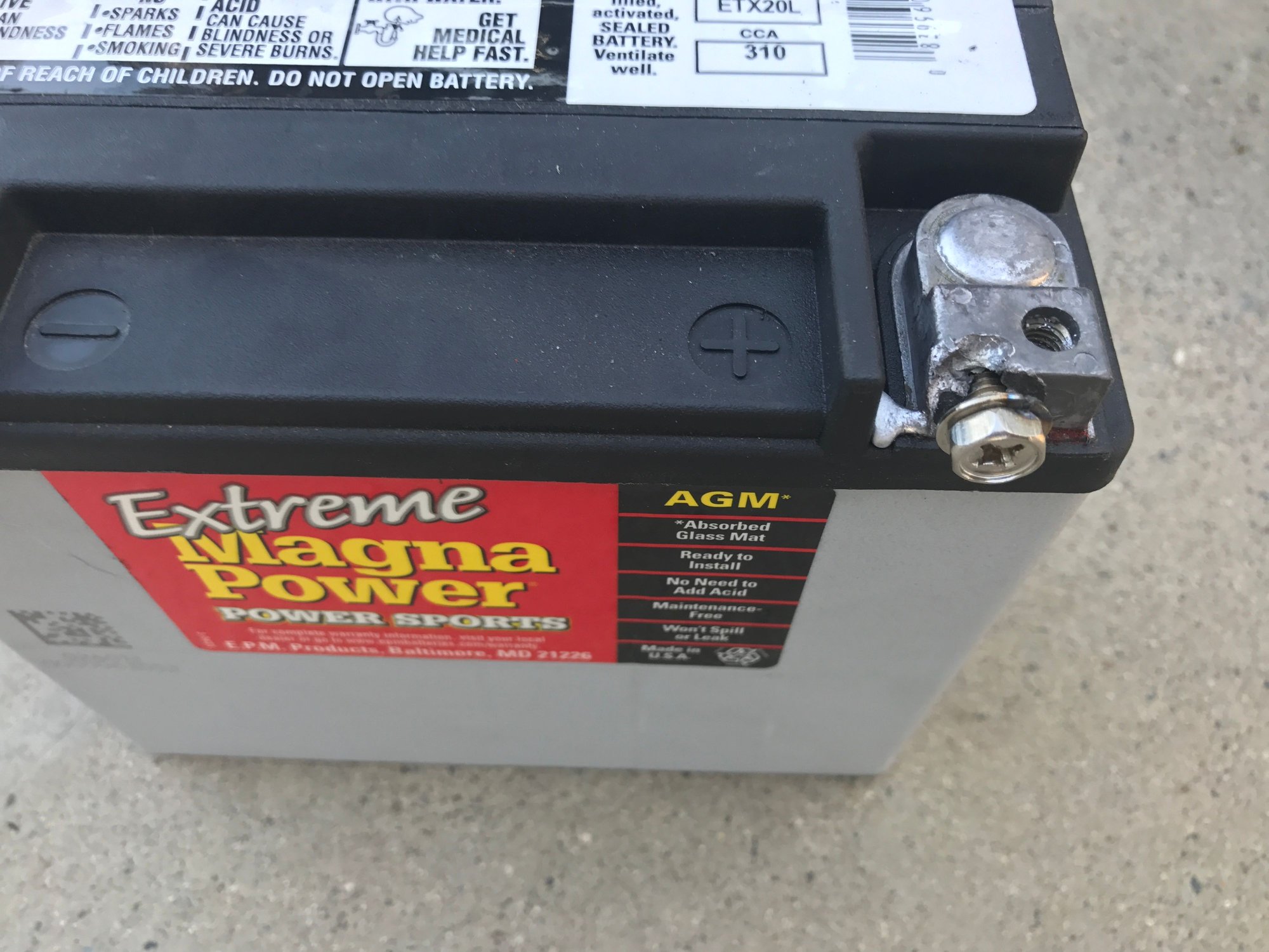

The bike s stock except slip on mufflers. Tried to do clutch adjustment but couldn't break the jam nut loose.
found my battery like this though

Install a new battery and let us know if it stops the issue. Good eye.

Ok, so had the battery tested and they said it's fine.
Got if a new one and put it in and bike has been running fine so far. Will post if any thing changes
