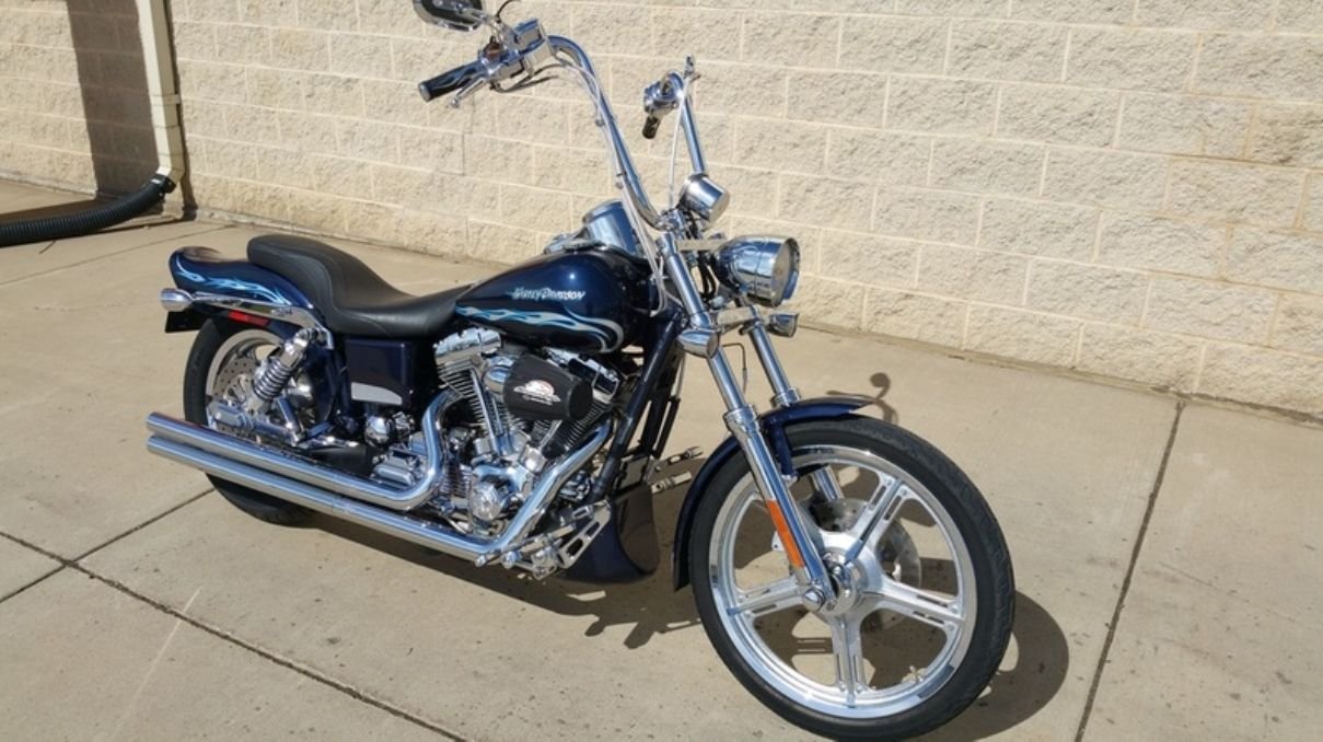

Sorry for delay. My 02 FXDWG3

Do you have a pic of the other side of the bike?
Nice looking scoot....

Thanks. No I don't have more pics. Now it sits in corner of my garage waiting for spring to come. We got cold and windy time here. I can't wait to start riding the beast, This bike is all about performance and power. Will show you more pics in CVO section when weather allows me to take it out of garage.

Nice bike!
