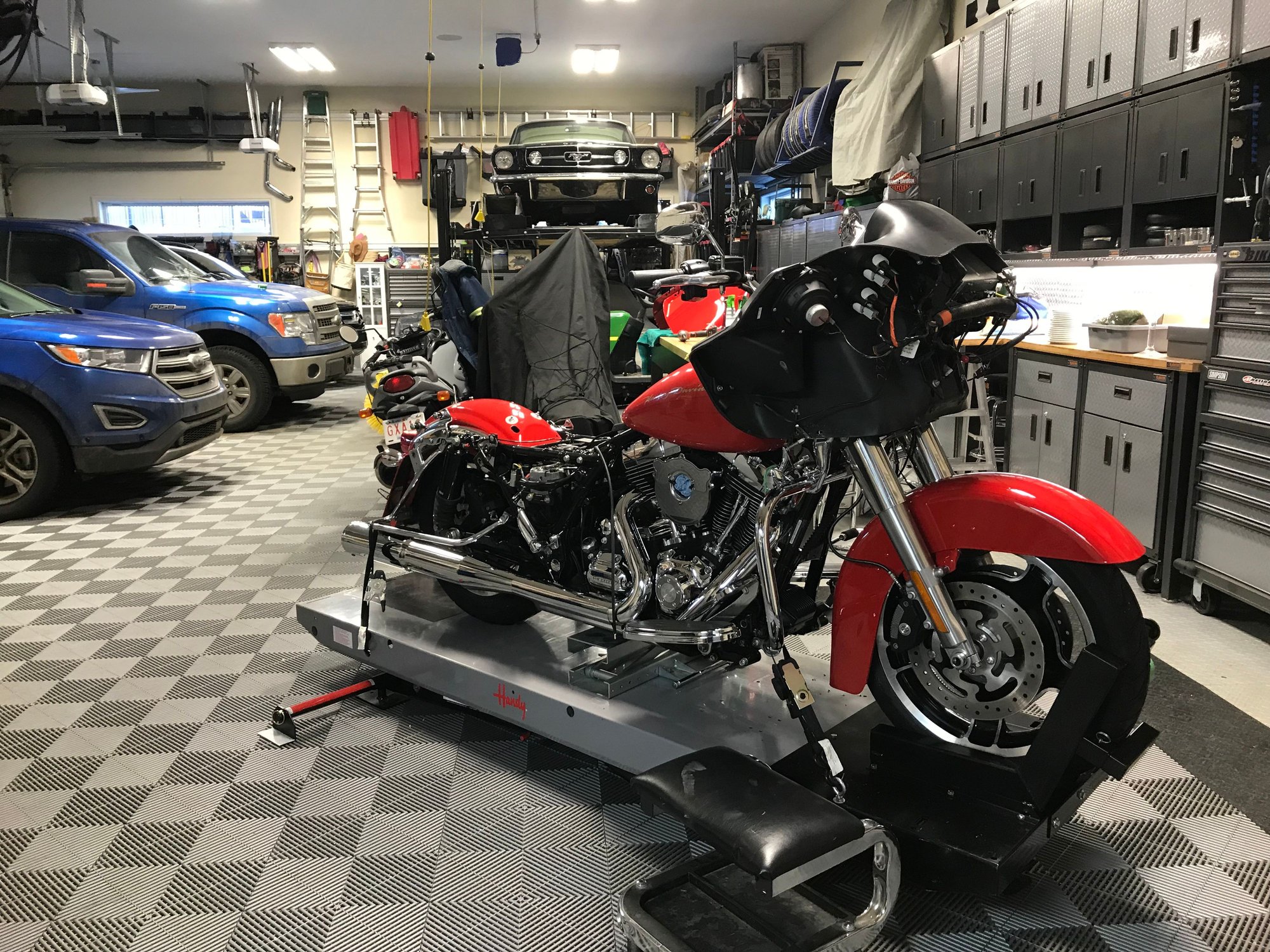

I had the Condor wheel chock on my previous lift but I now have the clamp style on my Handy lift. The chock can be a real pain in the a$$ to get the road glide out of compared to the clamp.
I look at that picture and think, damn I want that garage!
