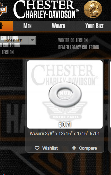

Originally Posted by DanRC
35078-79 - Hex Nut 3/4"-16 x .391 x 1" UNF
6701 Flat Washer, 3/16 in, 1/4 in ID x 9/16 in OD, Steel
From a 2015 Dyna parts book

From Chester HD
