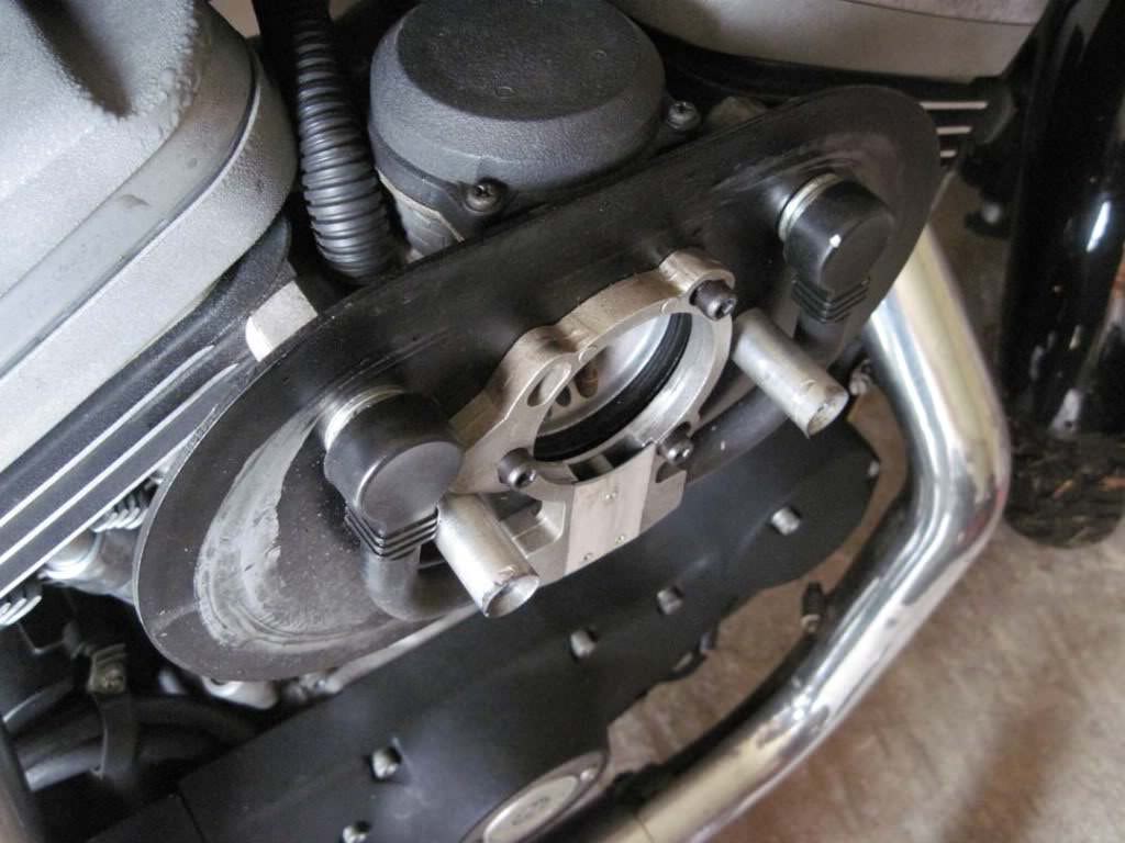

sometimes a picture says 1000 words. a little spritz of carb cleaner will remove oil and the lock-tite should grab. one thing to remember is that lock-tite is not a filler so threading should be in good shape. i cannot see the need for it to begin with.
perhaps a mod can be made to change up the whole system.
Attachment 611098
i made stand-offs that stay attached to the heads and use breather bolts internal to route vapors to inlet stream, no oily mess.
