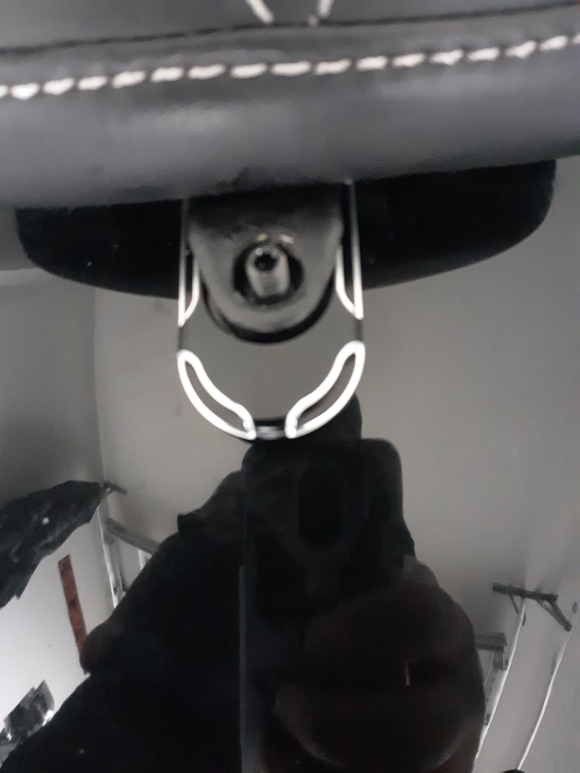

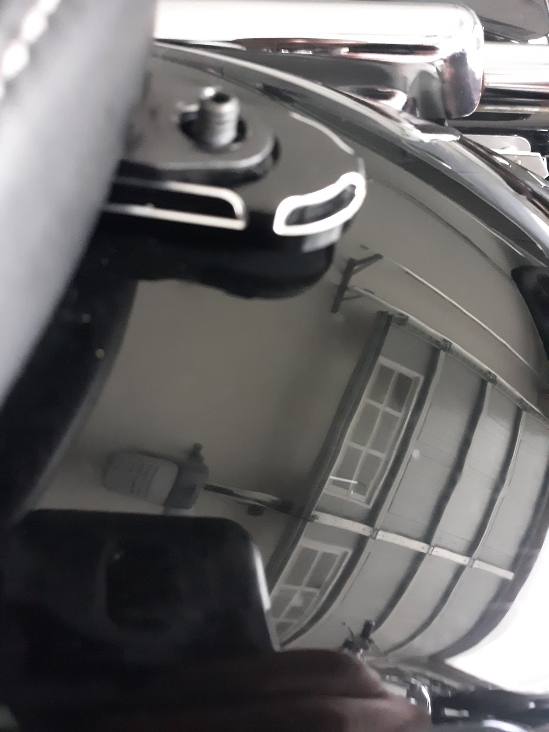

I'm trying to figure out how these decorative seat tabs are suppose to install.
Is it like this?
Thanks guys

Is that laying on top of the seat tab that is attached to the seat? Maybe this tab, just doesn't fit mine. Thanks.

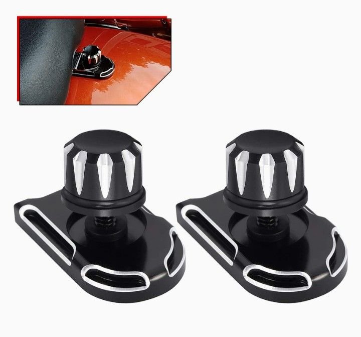

The decorative piece should slide on top of the seat mount and then the screw goes through the decorative piece and then the seat mount bracket.

The cover attaches to the top of the seat tab with double sided tape. When the included seat bolt is tightened down, the bolt fits into a circular recess on the top side of the cover.

That looks like the seat tab on top of the decorative plate but what is that sticking up in the hole?
