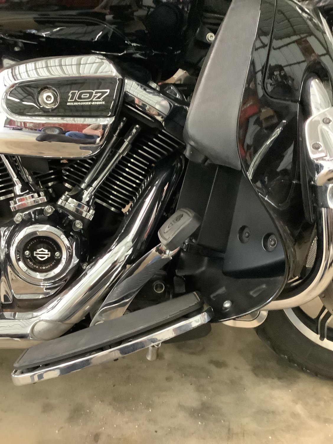

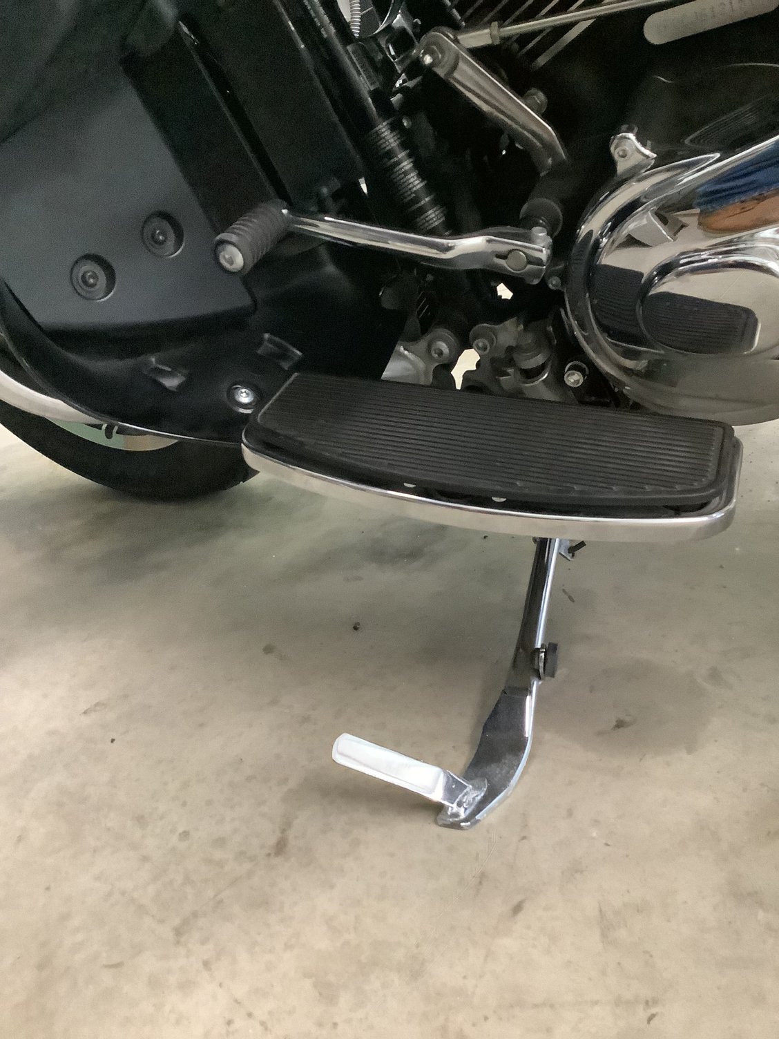

Yes. By adding 3/4" spacers from Softbrake.
2019 RGU-
Same set up on 2020 UL-

The top pic is a +1W NP (Narrow pedal)
Lower pic is a +1W

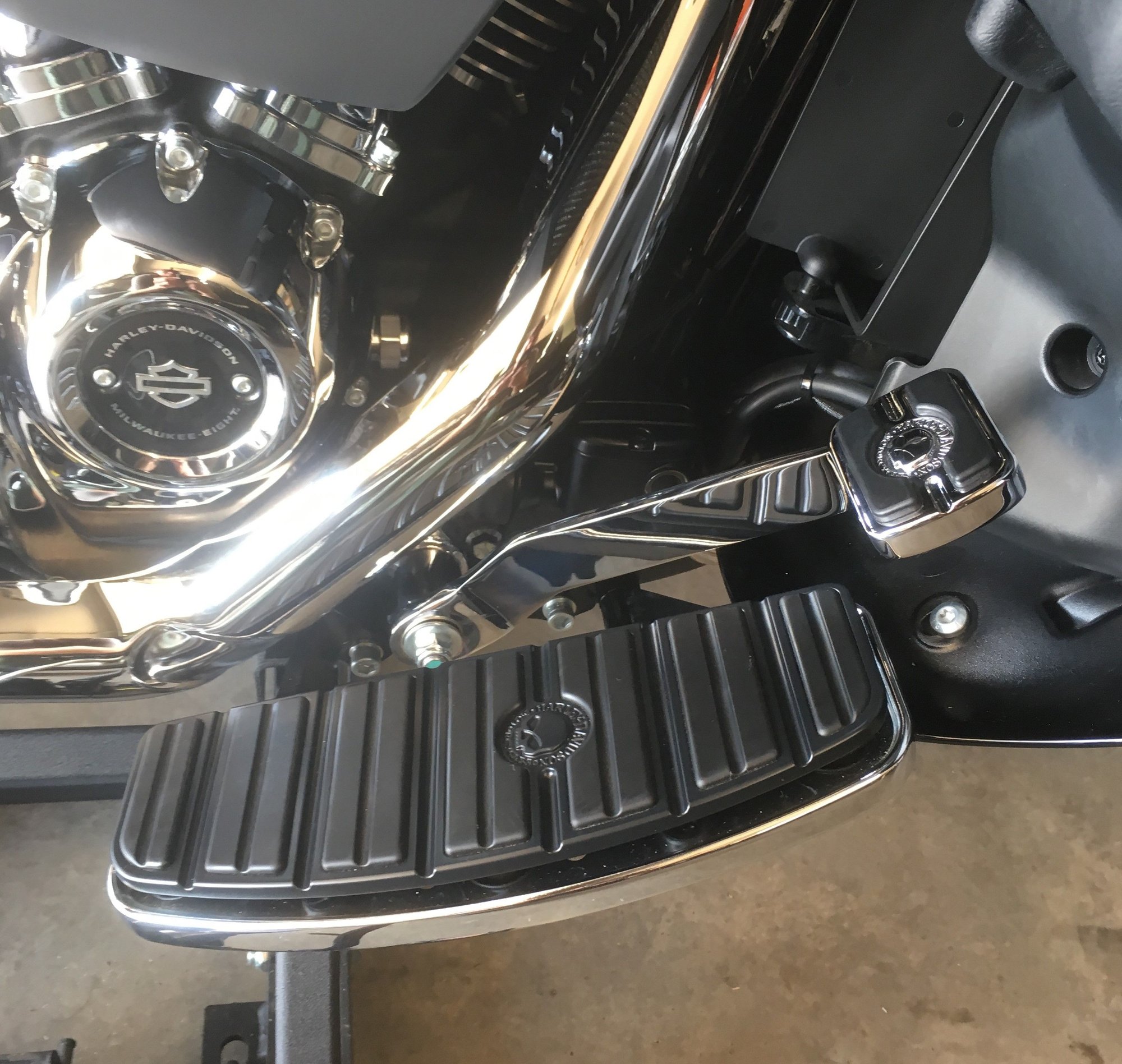

I wanted to update this thread with my experience on the Tall Boy relocation brackets. I ordered the 3/4” spacers and the Tall Boy brackets for my 2018 Ultra Classic with lowers. After mounting everything loosely and moving the floorboards back as far as they would go, and then securing all the fasteners, they do clear the lowers just fine. But, when pivoting the floorboards up as would happen if you happen to drag them, they did catch the lowers on both sides and bend on them pretty good, I was afraid that they could eventually crack under the stress. They may have been fine, but I just didn’t like that they caught the lowers when they pivoted up. I notched both lowers just enough to clear when pivoted up, with a jigsaw. Took off probably a 3/16” X 1” portion to clear the floorboards on both sides, didn’t take much. I’m 6’ 3” with a 38” inseam and my custom seat is extended 3 1/2” back,, but that just wasn’t quite enough. I think these just might do the trick! I may do the extended brake in the future, but right now everything seems pretty good. WB
