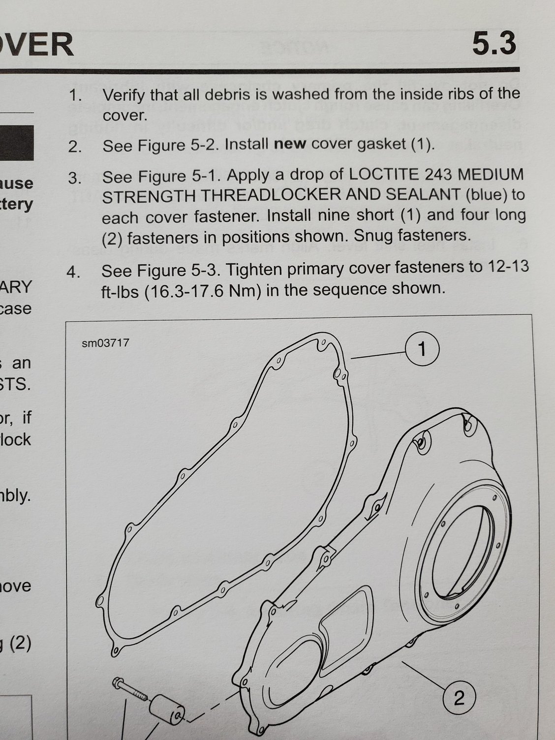

Originally Posted by Rounders
Primary is commonly changed, and those are dry, if I recall right, for factory bolts.
Here ya go

Tightening 1/4-20 to those belt specs, will require that you have a few helicoils / time serts on hand..
The purpose was to show the application of thread locker
Understood.. Just pointing out what I consider an error in the manual..
