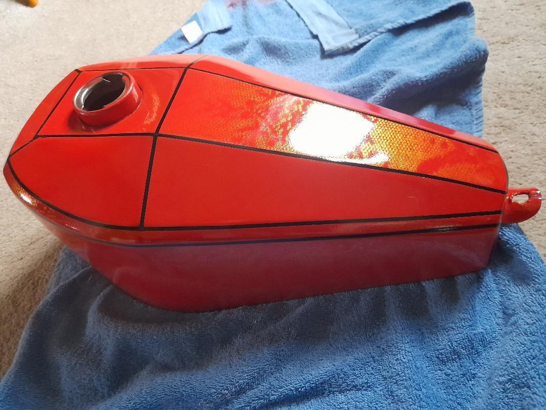

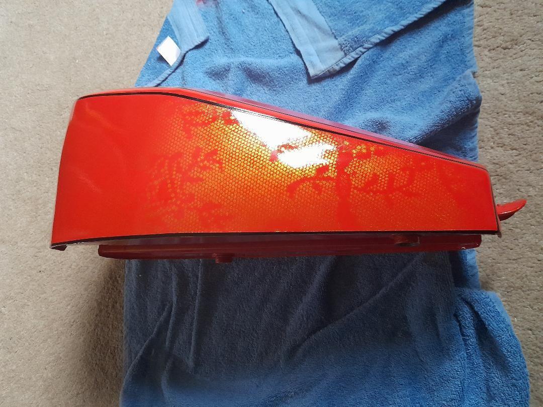

My chop tank, post office red with candy corn gold lace

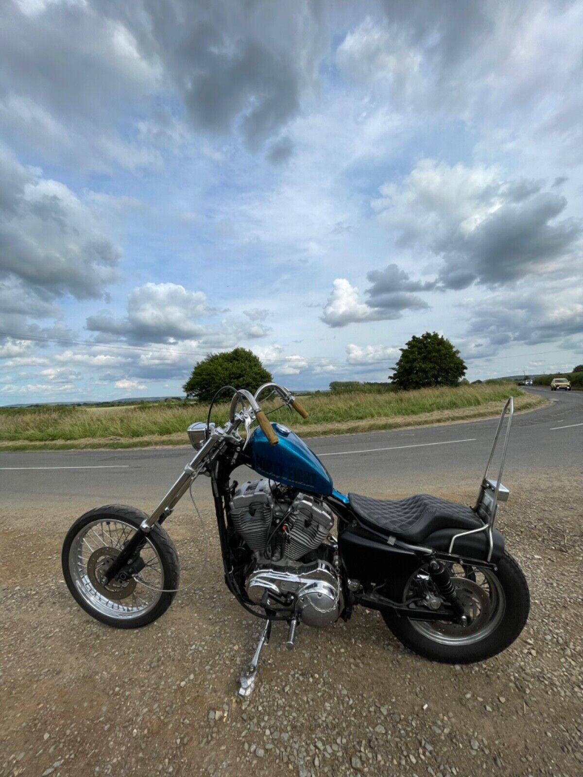

Sportster chop as it is now
