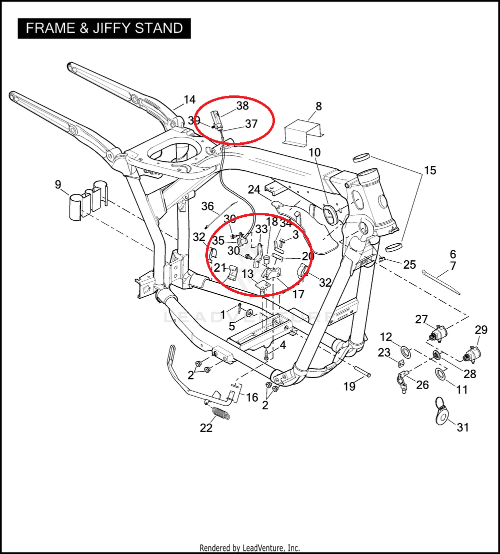

Your kickstand / jiffy stand safety switch is not working correctly. Needs adjustment, has come disconnected, or is bad and needs replaced. See diagram.
Ref:35
50278-08B
SENSOR,S-STND
This part replaces 50278-08A.
Price: $70.02

Thanks man, I found what you said and it makes sense.
Now the bike works if I fold in the jiffy stand. still dying when i drop out the jiffy which seems a bit wonky with the N gear in but at least now i have something to go on.
And if I can't find the fault, I can at least take it to a workshop
Thanks again!
