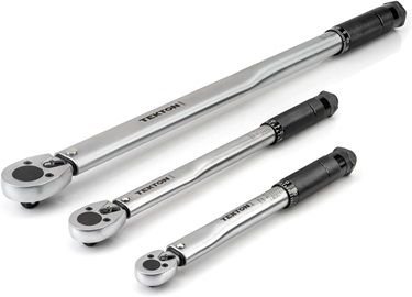

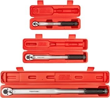

Post # 8 will get you what you need. Read your service manual for listed torques on your year and model of bike.
Originally Posted by CoolBreeze3646
1. As provided above, if you have a series of bolts/screws that hold something in place have them torqued to the same value limits warp of the item.
2. If you are putting a steel bolt into aluminum, using the correct torque will limit pulling the aluminum threads.
3. If you have aluminum wheels on your cage, torquing them correctly will limit warp on your rotors.
4. You can tighten many single fasteners by hand if you have a feel for it (spark plugs, oil & primary drain plugs. However, you can over tighten or under tighten and it may affect the item being stressed incorrectly or getting loose at some point.
5. For the handyman that does not use torque wrenches on a daily basis, these from Amazon are of good quality, come with calibration certificates and are real close to the specified value +/- 3-5% depending on if you are on the lower end or upper end of the torque setting. (tested with my digital torque adapter).
6. Set of three for $165.00 will get you most any torque you need for your bike, car, or truck.
7. There are many more expensive brands that are better quality and made to be used daily on a continuous basis. I have a set of these and have been using them for going on 8 years now with no issues.
https://www.amazon.com/TEKTON-Microm...rch_bia_t&th=1
NOTE:
The above information, while credible, is worth what you paid for it and should not be considered gospel.
Do due diligence, research and have a H-D Field Service Manual before working on your bike.
You will probably have many opinions and suggestions presented; make sure you research the person providing the helpful information as there are some who provide good information that is useful and some who speak out of other orifices with gibberish. You will figure out this quickly.

Adding another vote (and user) of Tekton torque wrenches, I also have all four--1/4", 3/8", 1/2", 3/4"--from Tekton. Very pleased with ease of use and reliability. No, I've never calibrated them, but I stick to the book values for torque ranges and have yet to have an issue.
