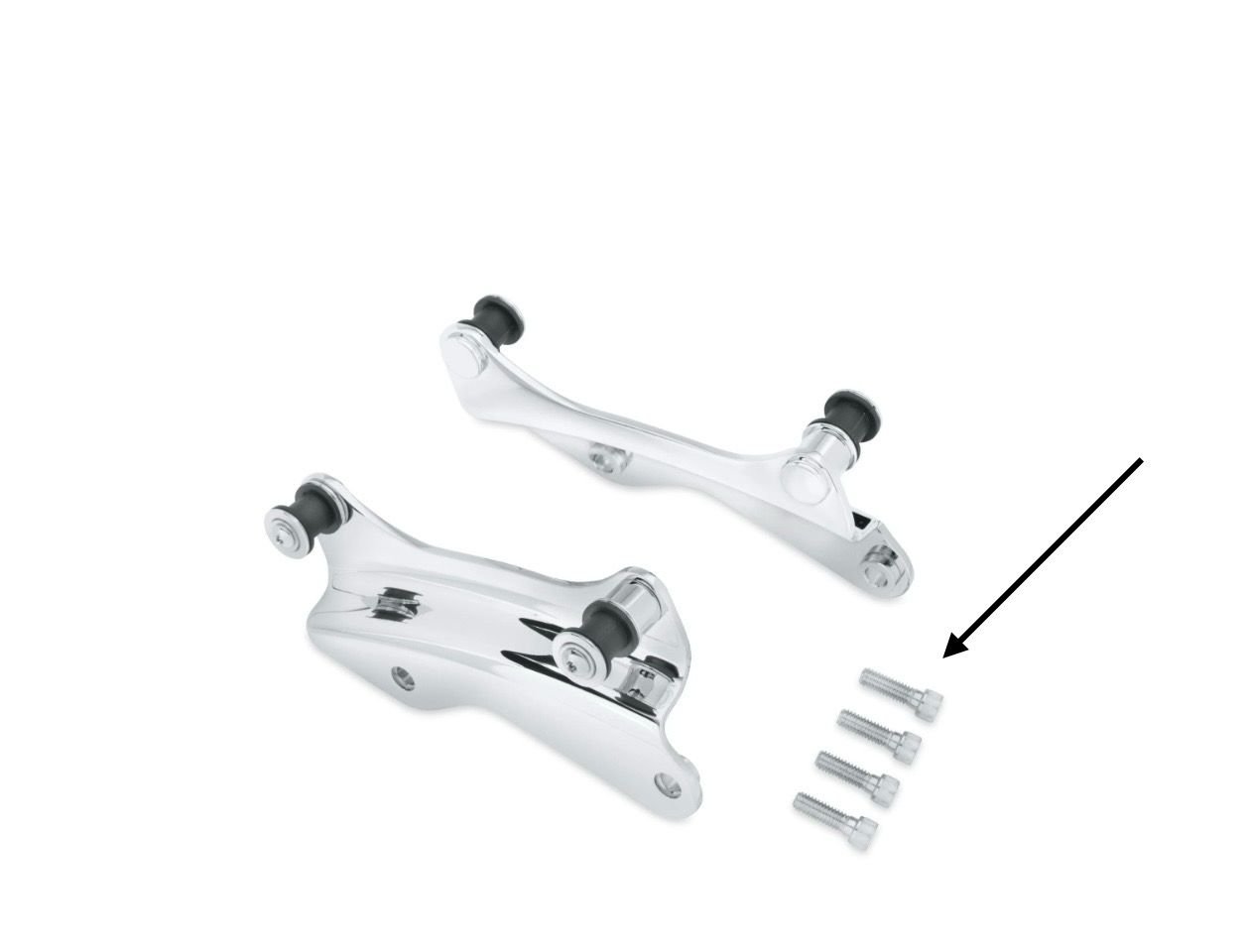

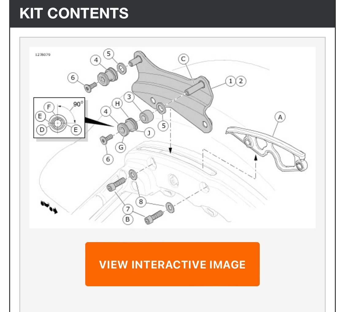

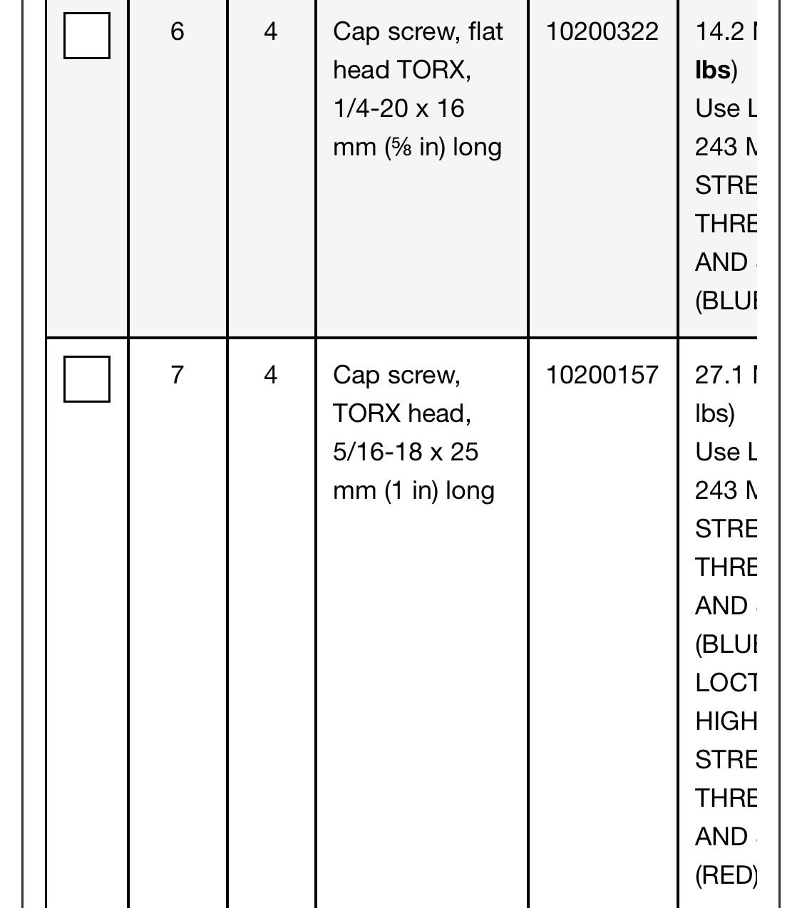

Anybody know the bolt/ screw size for the docking hardware? The part is # 52300353
I have a pair of brackets, but no bolts.

YESS!!
Thank you, sir!
