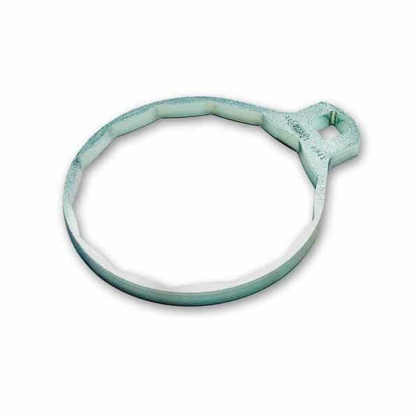

After buying one, I decided to make one that fit the S&S, Wix and Napa filters with 15 flats. After a steel beta test wrench, I then later cut one from Aluminum.

Might not help you out right now, but for future needs look into the Rivco Oil Filter Wrench. This will take them off no matter how tight they are. These fit OEM filters with 14 flats. Some aftermarket filters are different.
https://www.rivcoproducts.com/shop/h...vidson/hd-021/
That's not going to work on the OP's bike unless he removes the oil cooler.
Jim's USA has one for those situations.
Added: Rivco also has a small wrench for use with a 3/8" drive.
The RIVCO “Mini-Wench,” Oil Filter Wrench
https://www.zippersperformance.com/758-941/

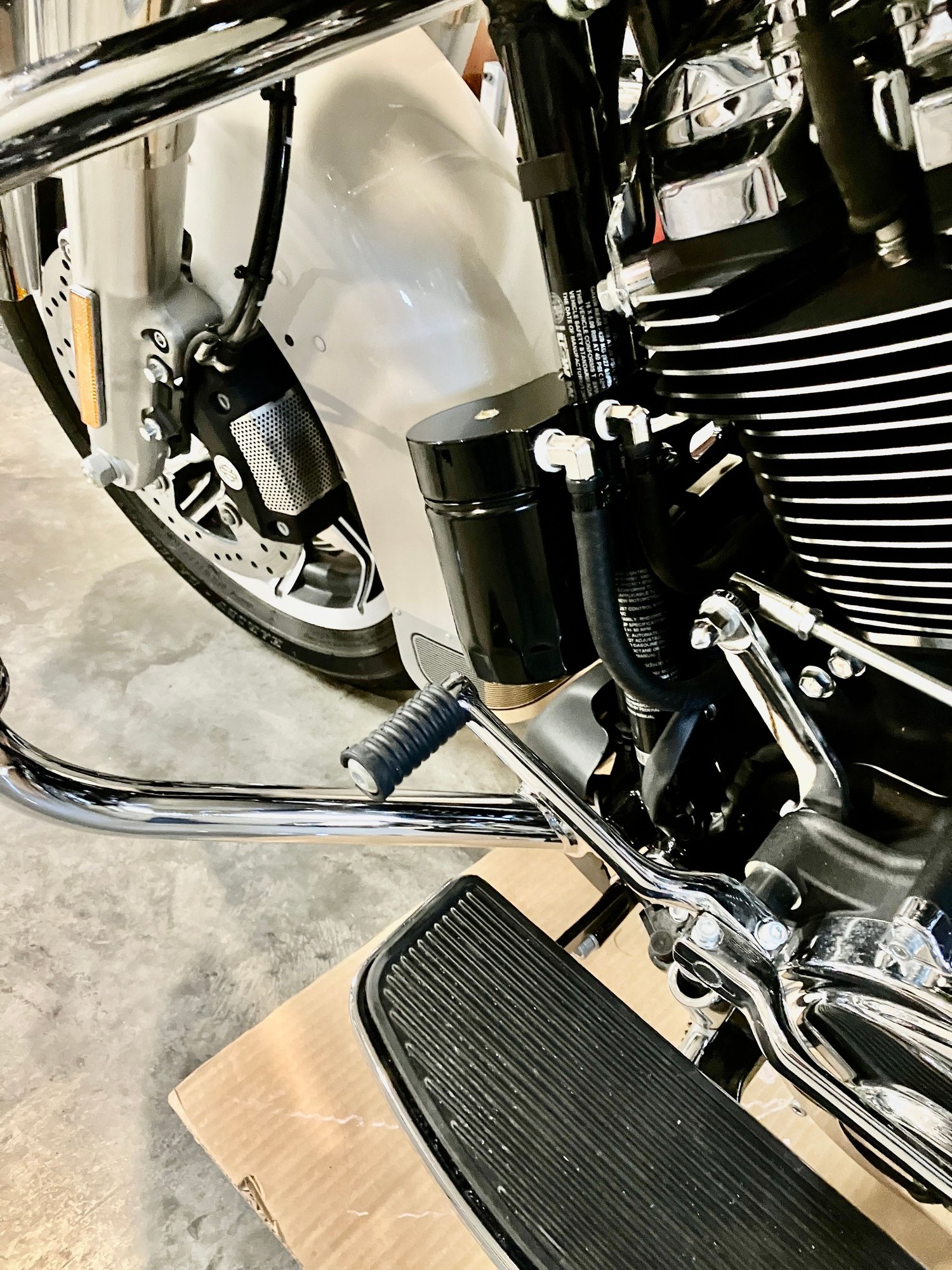

DK Customs oil filter relo kit.
