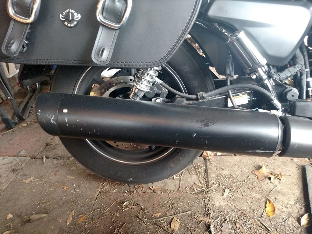

Next was the exhaust. The stock it too quiet. IMO this is a safety issue.
Others on the road cannot hear you and the rider cannot hear the bike. we went with a firebrand loose cannon.
on the stock you can see some of the scarring from the previous owner
here you can see the size difference between the two pipes
loose cannon installed
