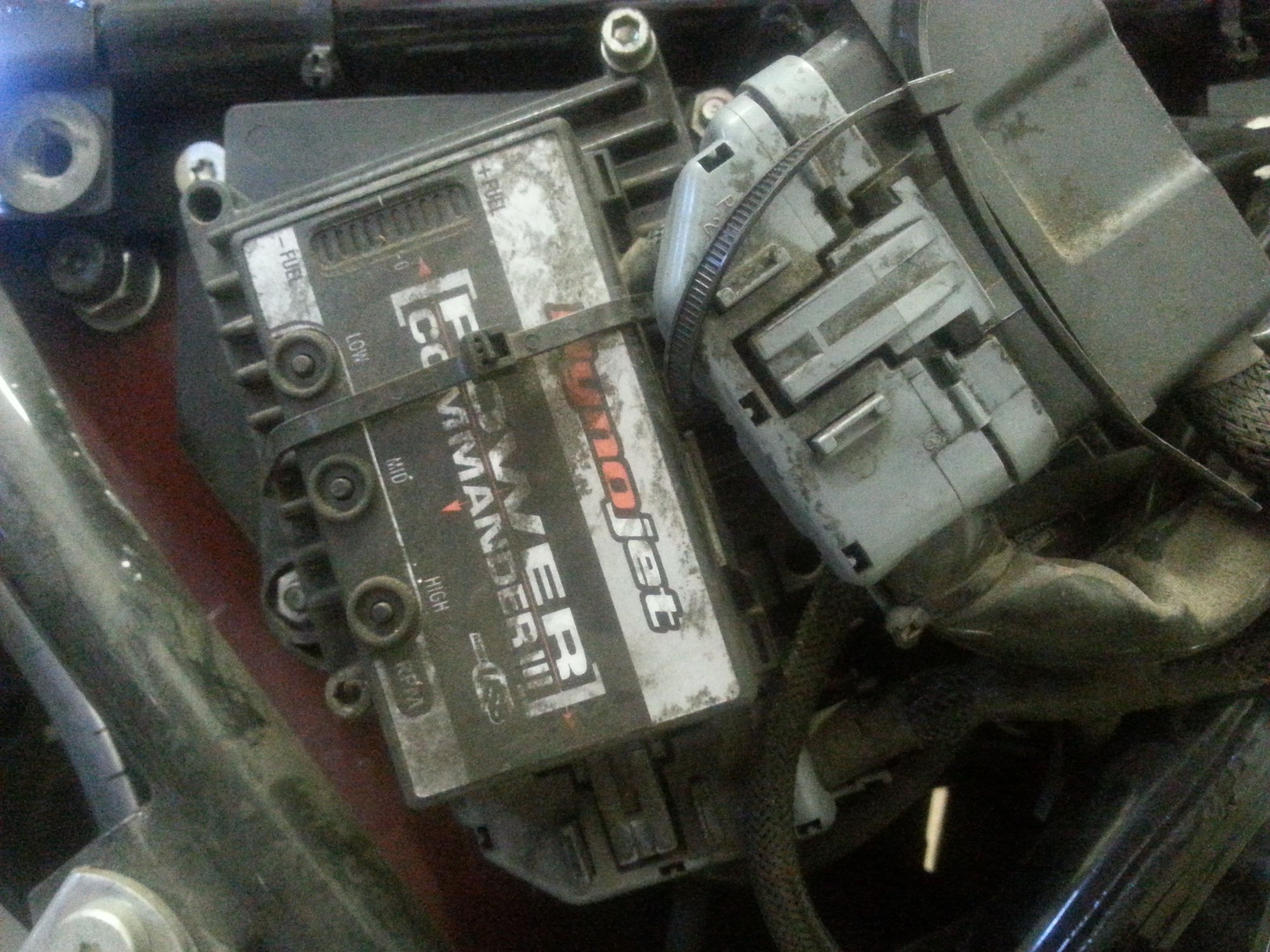

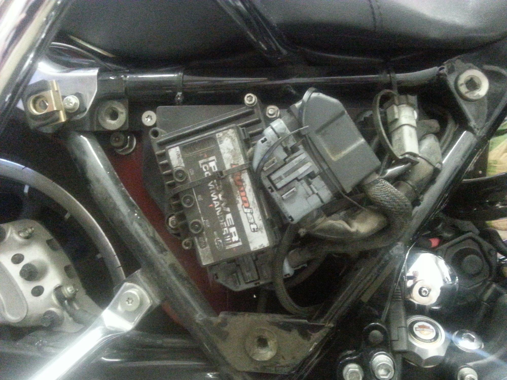

Sounds like it has PC3 or a Thundermax installed take a photo under the sidecovers and under the seat so we can see if possible.

Old Jun 30, 2019 | 07:37 PM
scotty3's Avatar
scotty3
Joined: Feb 2007
Posts: 704
Likes: 23
From: on the mud flats on the edge of slum city
There you go you have a Power Commander III (PC3) attached so if you look for a tuner that does the PC3 and make sure they can do fuel and timing on the PC3 you can have a sweet running bike in no time if there are no other problems.
