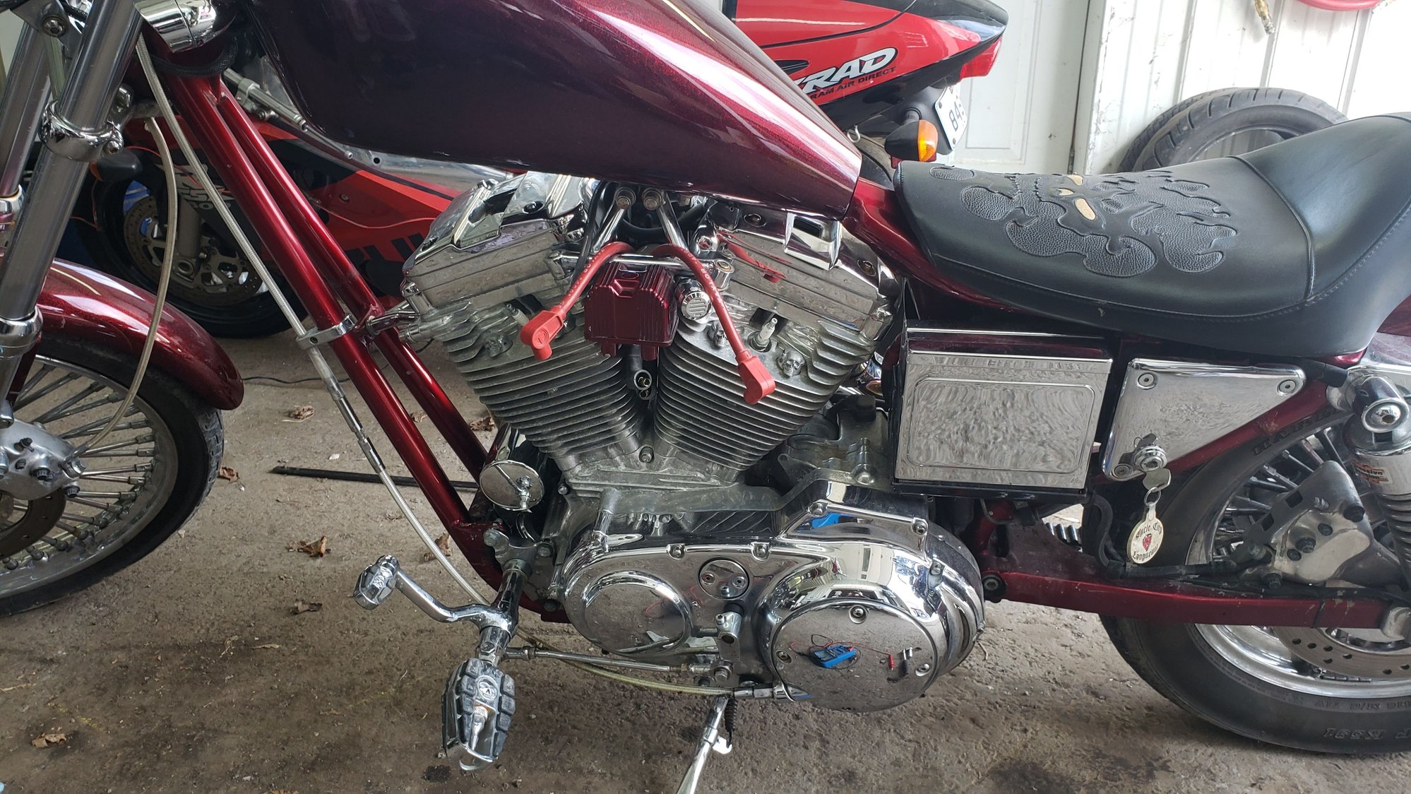

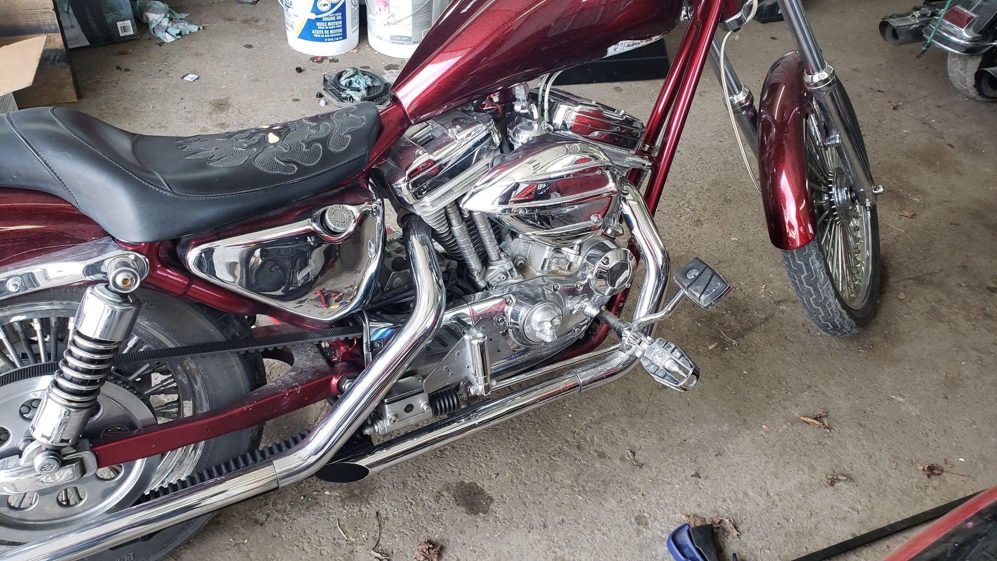

Old Apr 5, 2021 | 01:13 PM
Mick85's Avatar
Mick85
1st Gear
Joined: Mar 2021
Posts: 5
From: montreal
hoses have been changed lol
here some pics! didn't see any fuel filter, test resistance of coil, seems good, plugs too, I don't want to put all new parts cause it's not my bike but it'll be fun to fix it lol

ok today I've put brand new plug and clean the little wire connection on the coil. start the bike and get out of the drive way and again the rear cylinder wasn't firing up, got back to the garage and try to switch little signal back to front and same for spark plug wire to see if 1 of the 2 coil in the coil was bad but the problem didn't change place. rear cylinder is firing but seems weak cause when I unplug spark plug wire from front cylinder the bike die shortly but can run forever on the front cylinder. So at this point I'm wondering how it work behind the right engine cover cause the wire from the coil are going there, is a magneto giving signal to coil when to fire each cylinder? any test I could do at this time? can I remove this cover or it's a pain? ok made some search and if I'm right I only have to get this skull face out and see what ignition module (cam sensor ) I have there! does it sounds right that this module could be my problem du to intermittent misfire on rear cylinder?
Thanks again for any advise

those have been known for failure. a fsm would be your friend here.
