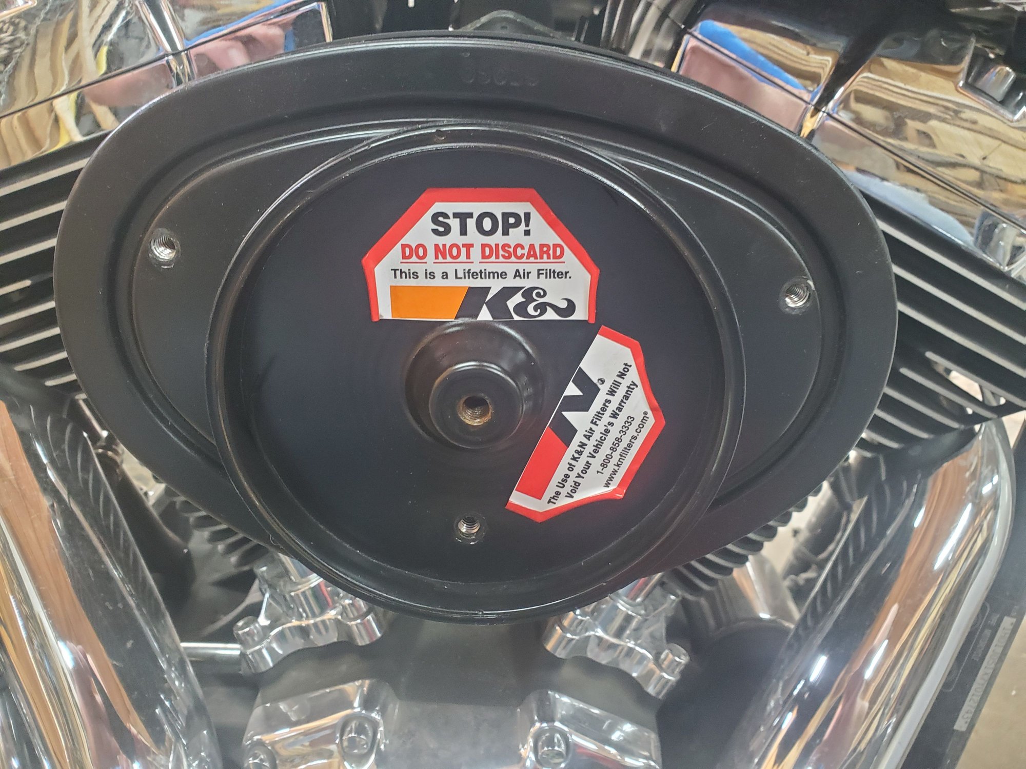

I'm the third owner of my 07 Deluxe. The second owner didn't know much about the bike other than the VH Big shot longs and he replaced the seat. The S.O. was a friend and the bike was in immaculate condition when I got it in 2017 with 15000 miles on it. I went to replace the air cleaner only to find the stock one didn't fit. I removed the cover to find a KnN so I cleaned it and put it back on. Just out of curiosity and the desire to put new CVO255 cams in it. What is this? I can't see how to get the black plastic bracket off to find a model number or anything.

looks like a stock t/b. for that year they were 46mm..should be just fine for what you are thinking about.

You want to remove the backing plate.. 3 screws behind the intake bell and the 2 bolts with the **** on them..

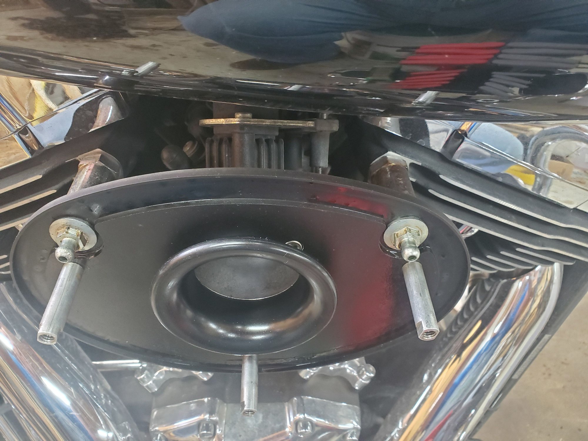

I thought the same thing. I took the three screws out, the two **** came off, but the plastic seems to be melted on to the breather bolts behind. To the point it looks like it could have been molded that way. That didn't seem right. I may have to see if i can get it off. The breather bolts have some rust on them and i need to get them off to clean them up. Thank you Max Headflow.
Is this just a KnN performance or high flow air filter?

It may be glued on in some way... Yours is an RK-3910. The current one is a -1.

Thank you again. I've looked for a couple years on the Harley parts site, JnP, Revzilla, Amazon. Everywhere I could never found an air cleaner/intake that looked like it. Is it a good one for my application going to CVO 255 cams?

Yeah, it's fine... Better than most...

Looks like a small velocity stack. Should help with the low end...
