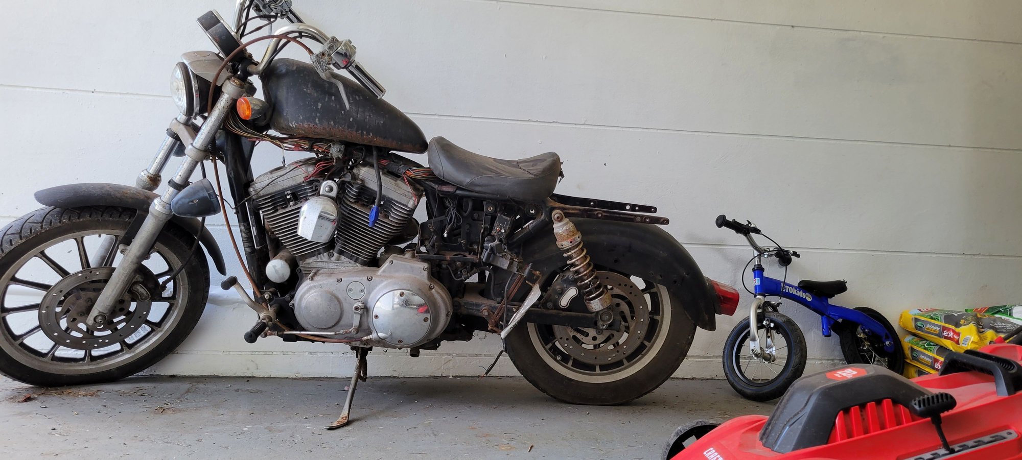

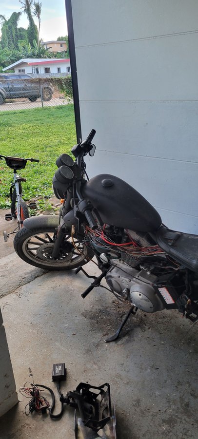

Hello All,
I recently got a dead bike up and running. I am no mechanic but I do enjoy tinkering on my off time. This one took a bit. Was a bike that hadn't run for a year. Sat for 2 years in my garage as I slowly tinkered.
Problems: Would turn over, rarely sparked, would backfire through carb occasionally, would give big "woompf" and fire from exhaust, never actually ran. Solution: ordered dyna tech through advice from other forum, then had to order mechanical advance. Put the advance on with the stock springs, put the dyna tech on at around 3 o'clock position. It runs!!
Took it on a trip around the block. Backfires almost constantly if I twist my wrist enough. Back fires occasionally at idle but I think I got that taken care of by adjusting the settings on my s&s carb. I'm thinking it's the timing. Could it possibly be the springs on the mechanical advance? Do they need to be the heavier ones? Wife chased me off for making too much noise before could keep trouble shooting.
Sorry if this has been posted before, and I would continue on my old forum but it seems the site was shut down.
-Nick
Current and running!

Someone must of rigged up a different ignition for your bike. The original ignition module is a one-piece unit down in the nose cone part number is 32465-98b.. Also I would get a factory service manual so you can learn how to time it properly. Bike looks a little rough but with some TLC you should be okay.. Good luck..

[QUOTE=98hotrodfatboy;21443012]Someone must of rigged up a different ignition for your bike. The original ignition module is a one-piece unit down in the nose cone part
It was stock. I ordered a used stock part and buttoned that up and still had the same issue as no start/rare spark. My original ignition module you could turn it and it would light up at correct timing. But as I would crank, the led would flash. Trouble shooting guide says bad part. The replacement OEM part had same issue. Could have been 2 bad units but idk. I haven't done static timing with manual yet.
Bike is rough. $500 buy just to putt around on island.

So I putt around for about 30 min today. Lots of elevation change here in Guam. Going up the hills I did not have a lot of power at all. I was climbing in 1st gear most of the time. If I twist my wrist too much, backfire.
I'm thinking my bike don't have any baffles. It's loud. I don't have a working tach (ordered an induction tach). I've never owned or ridden a harley. Maybe I'm mistaking what 1k rpms sounds like? I turned up the idle and we'll see tomorrow if she rides better. But all my old bikes the idle was basically as low as you could get out without it dying.
