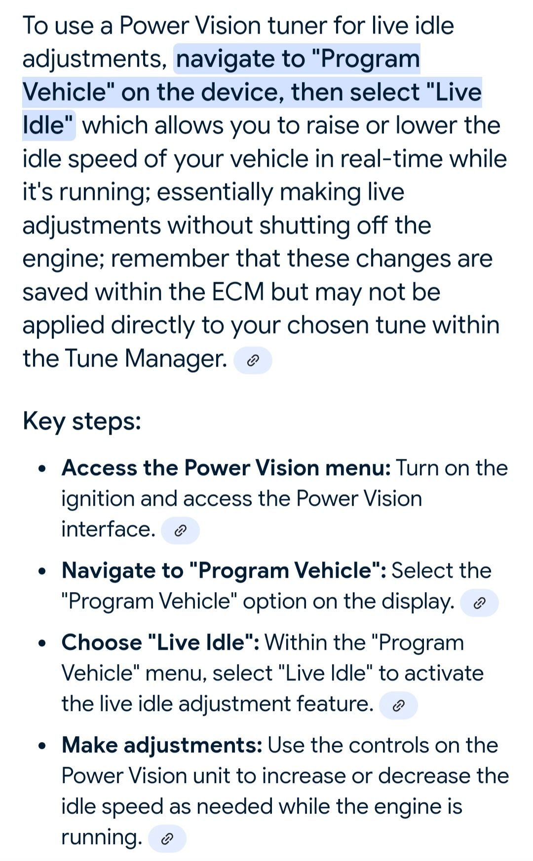

I know in my PV 2-B I can go into live idle and adjust the desired idle speed up or down. You should be able to do that with the PV4 as well. Here's what I found on Google..
