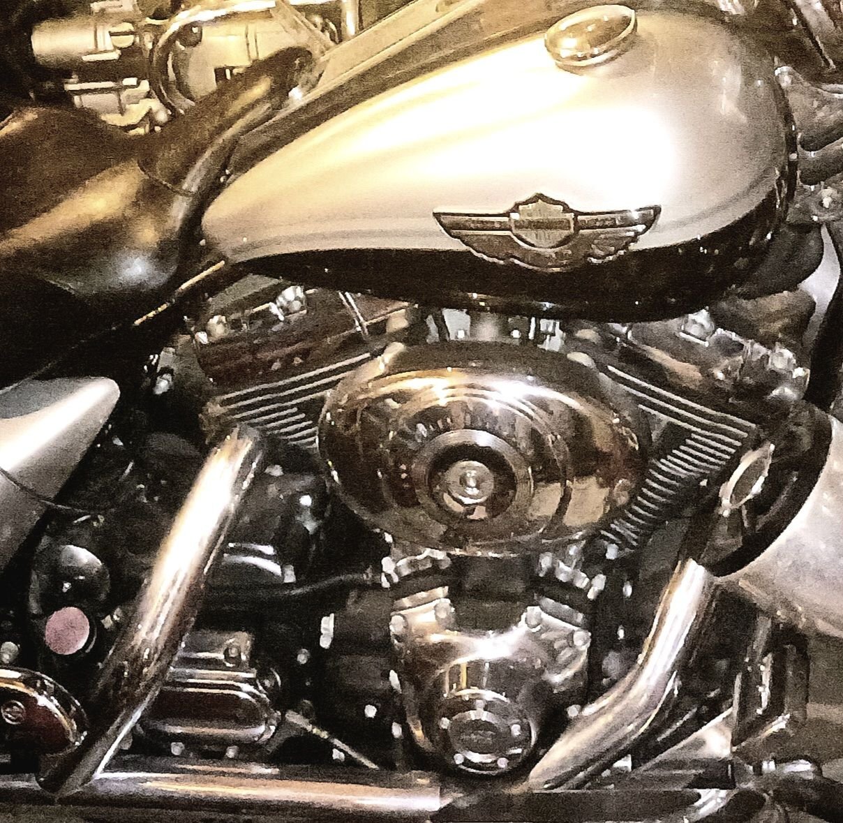

TheNeonGuy here. Same problem still happening. I own EIGHT motorcycles. So I've just been riding them instead, including my 2002 Electra-Glide.
The problem is the same one I and others have been trying to solve for about three years!
She's a 2003 Road King with a stock Twin Cam 88 motor.
After a ride, I shut off the bike and the motor won't re-start. It happens whenever it wants to. Short ride, long ride, short interval after riding or overnight. No pattern to it. Happens in any weather, Summer or Fall or Winter. It happened two days ago. Waited 8 hours and then she started!
There is no voltage from the relay to the fuel pump. The motor will run on starting fluid. There is spark. After waiting usually 8 hours, sometimes for days, the bike will start and she runs great. Buy it's a crap shoot whether she'll start again after going somewhere.
I've read about several other guys having the SAME PROBLEM, on this Forum and on others, since I originally posted about it, a couple YEARS ago or so.
It's frustrating to see the SAME ISSUE plaguing other Harley owners, with nobody having a clue and no answers.
Don't tell me about a weak battery, bad wiring connections, holes in the fuel lines, bad relays or circuit breakers, bad battery ground connection, blah blah blah.
Been there, DONE THAT! All that and more have been checked, over and over again. All those things check out FINE!
This Road King is a garage queen, never been outdoors overnight! No rust anywhere, no corrosion, never even been in the rain, not even taken to a car wash!
The problem seems to be that there is no voltage to the relay that sends volts to the fuel pump because apparently the ECM is not sending the voltage or not grounding the circuit which allows volts to flow to the fuel pump, whatever the case.
I need REAL HELP here, and the damned stealership won't even talk to me. Dallas Harley-Davidson does NOT work on older bikes no matter how much money I offer them!
I'll NEVER buy a motorcycle from that place.
Anyway, please see if you gentlemen can advise me what to do/check/replace next.
This Road King is beautiful. She's the 100 Year Anniversary Model with Mustang seat, Vance & Hines pipes, black & silver paint, 1000 watt, four speaker stereo, silver pinstripes, and a newer, matching Harley trunk. She looks fantastic and rides GREAT.
I want to keep her and ride her til I drop dead.
I'd hate to sell her with this problem.
Maybe the ECU is bad? Maybe the crank position sensor is intermittent? Might be the variable speed sensor? I understand the CPS sends a signal to the ECU to let it know the engine is running, which triggers the ECU to activate the plunger in the relay, closing the circuit inside, sending voltage to the fuel pump.
Again, there's no voltage TO that side of the relay, no volts from the ECU. I've paid three Harley mechanics over the last two years, hauled the bike to two shops, and NO ONE can fix it! Unbelievable!
Am I on the right track here with maybe checking the wiring from the ECU to the relay? Is there ANOTHER relay between the two? Maybe a bad ignition or kill switch? But how does she run on starting fluid?
What's the next step to correct it? I'm freaking out.
PLEASE ADVISE: what's the procedure to display a trouble code? I did it a long time ago but there was no code at that time. Can't remember how to do it now. It isn't easy like on layer models.
THANKS to all you guys, my Harley-Davidson-loving friends, here on Harley-Davidson Forums!
God bless you and ride SAFE!
