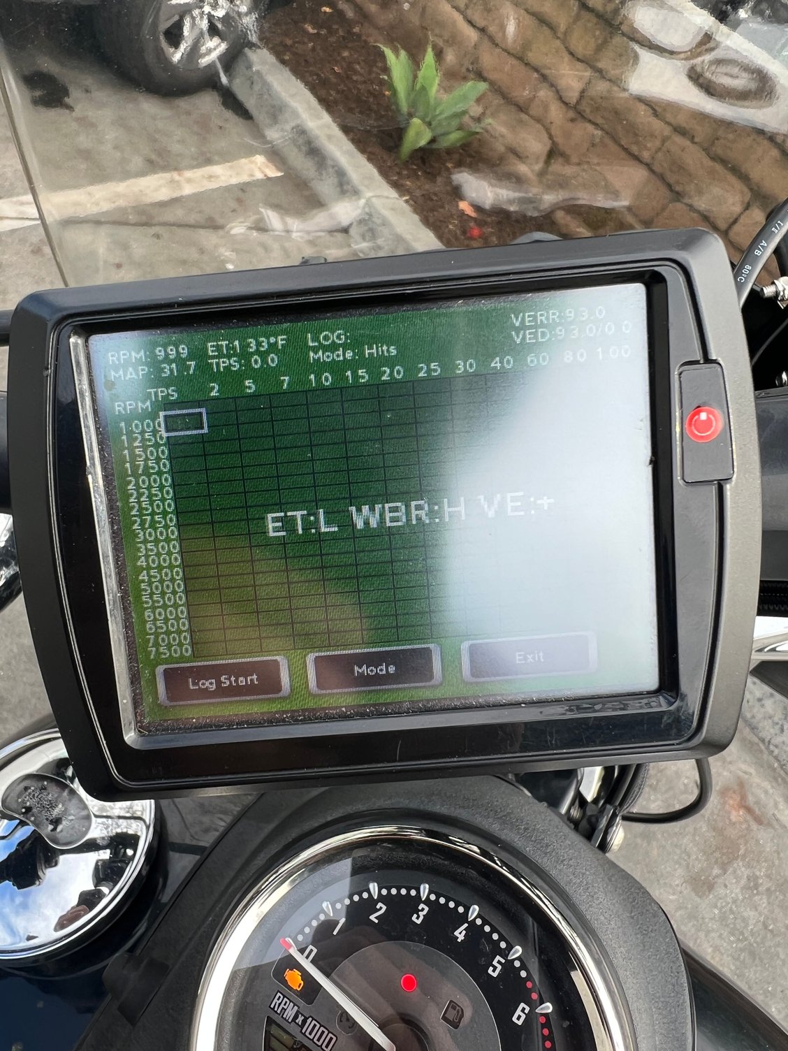

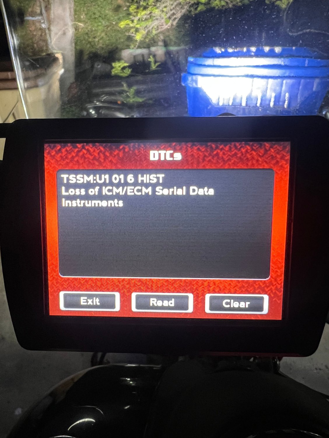

can’t get target tune to get any hits here are some error codes I’m getting bike runs real rough in 1st gear wanted to fix with target tune but can’t get it to work

First image shows ET:L which is engine temp, low. Temp is showing 133*F. AT won't work until >165*.
okay I lowered the temperature to 130 F, the idle to make corrections to 700rpm and kpa to 15 and the max wb lambda to 1.44 from 1.22
is there anything that I did that is wrong could mess up my bike just rode for like a hour or two and got lots of hits but the bike didn’t want to write the exported new map with lots of hits got general failure code then tried a 4th time with out resetting trims and values and it worked
