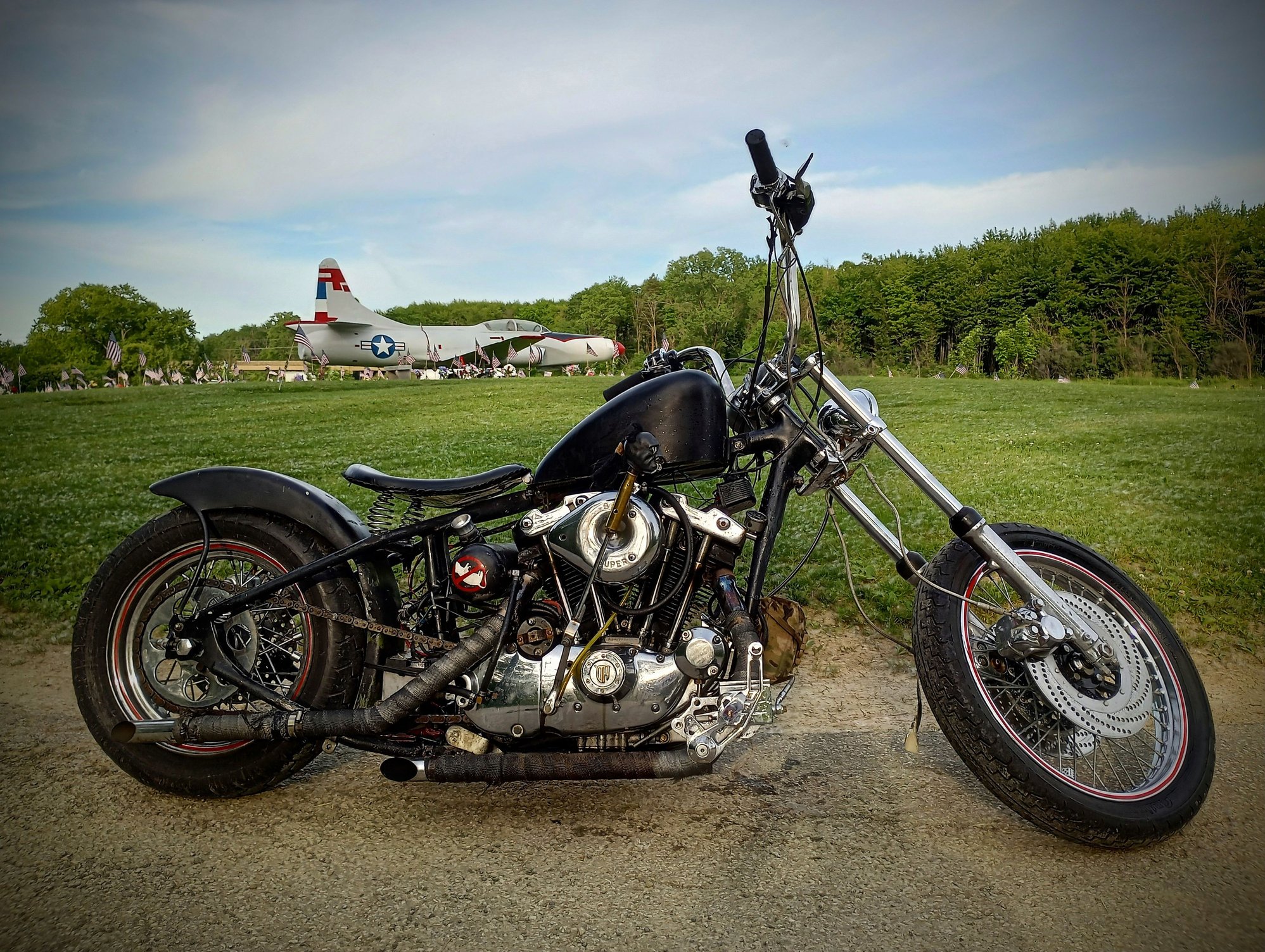

Not 100% certain if I have a problem here or not, but I'm gonna put my money on "I do". I have a '77 Ironhead. When the bike's off and still (no rocking etc). I can go through the gears without using the clutch lever. Shifting through gears when not moving. I'm hoping it's an easy fix, maybe just something with my adjustment(?) or, from what I understand, if it's the transmission, would I just be better off taking the bike out to the pasture and put a round through 'er? Was a strong running bike until one of my oil lines popped off from a connecter, resulting in my front piston smacking against a valve. Nothing more than a little "dent" in the piston. But, being it's been stroked, those piston heads are 4 times as much as stock, so that's another "suck it" that I gotta deal with.. But without getting off topic, if anyone can shed some light on this shifting issue, I'd be much

Texas, no I got all off topic for a minute. But I'll start from the beginning, and please let me know what it could be that happened, for real, I'm not being a smarta$&. So, last year I was riding and the bike had begun to bog so I pulled over, I'd looked down at the engine and saw oil all over and then a !BANG!, like something that shouldn't have happened happened. I'd shut it down. And saw where one of the hose clamps was securing an oil line had loosened and the line was spewing oil all over. I got it home and removed everything, down to where I could see the pistons, etc. and in the front cylinder the piston was "crushed" on the one side on top. Enough to where it cracked one of the rings into about 25 pieces. I recovered all, or hope I did, then got all new stuff and put everything back together. Then I noticed this deal with the shifting. If it's no big deal, then cool. I have a '99 Fatboy that won't shift unless your rocking, etc. but the Ironhead doing it completely still, just had me wondering if that was a bigger problem or not.

I'm having a hard time understanding what you are asking, and maybe others are too. So with the motor off you can pull the clutch and go thru the gears. OK, that's good. Is there anything else? How does it work with the motor running? That's where a dragging clutch would cause clunkiness and difficulty finding neutral. Does it shift OK when riding? Are you having any of those problems? Adjusting the clutch according to the Harley service manual would be the first step. Pulling the transmission (and primary and clutch) should be your last resort.
