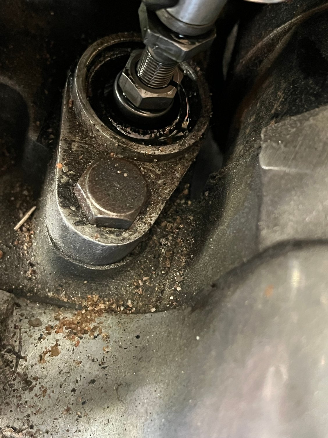

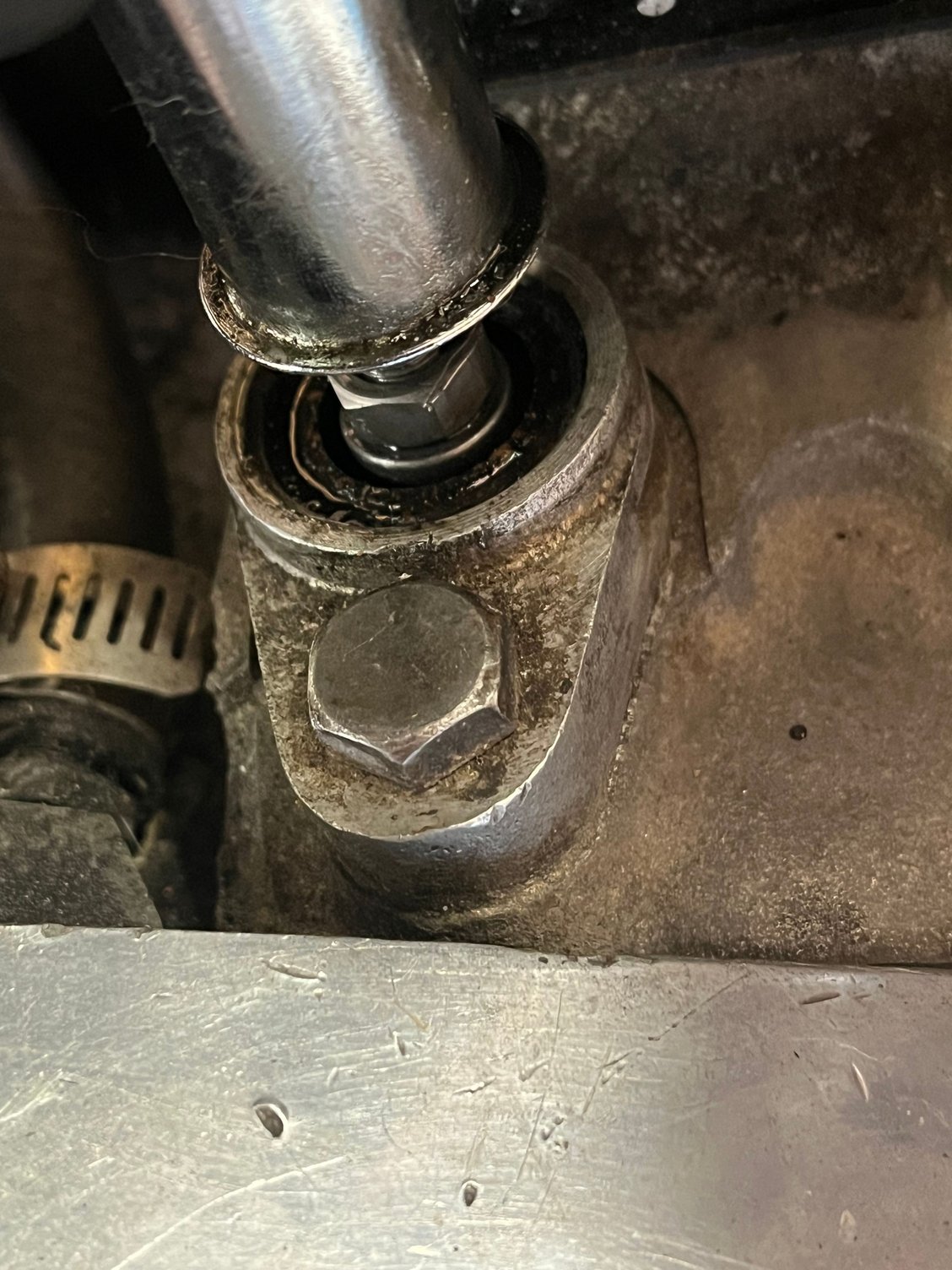

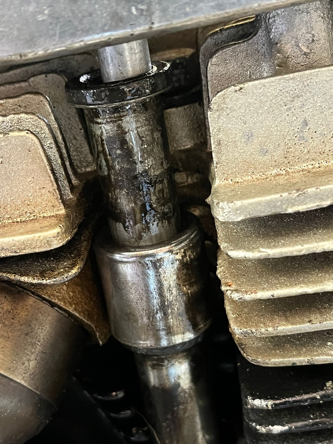

just adjusted the pushrods they’re pretty oily for sure when I was doing the compression test I could feel the compression on front cylinder but the rear I couldn’t feel nothing just kicking easily and barely got a reading. I can hear it when I kick through the intake pretty easy to kick throhhh but starts up right away and idles and runs through third decent but fourth there’s just not enough it losing power. I’ll definitely check the other stuff soon thanks!
