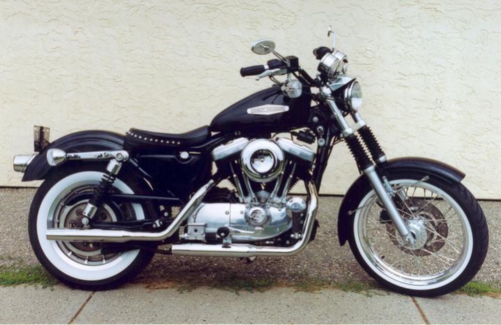

To me they're unsightly, leaky and heavy. Bikes never had them prior to EPA noise reduction standards...so what's that tell us? It's not like performance was recently discovered either.
Got 100hp/88ft lbs with these. And great sound
