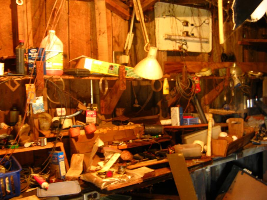

Default Garage Cleaned & Ready To Wrench
After 30 hard hours and 2 pick-up loads to re-cycle, shop is clean enough to start work. Still have drill press and a few other tools to install, but 90% there, except for the side room, which is another story, maybe a small paint booth.

Mine looks like the first pic Olgrampy posted. I assume that was the before shot.

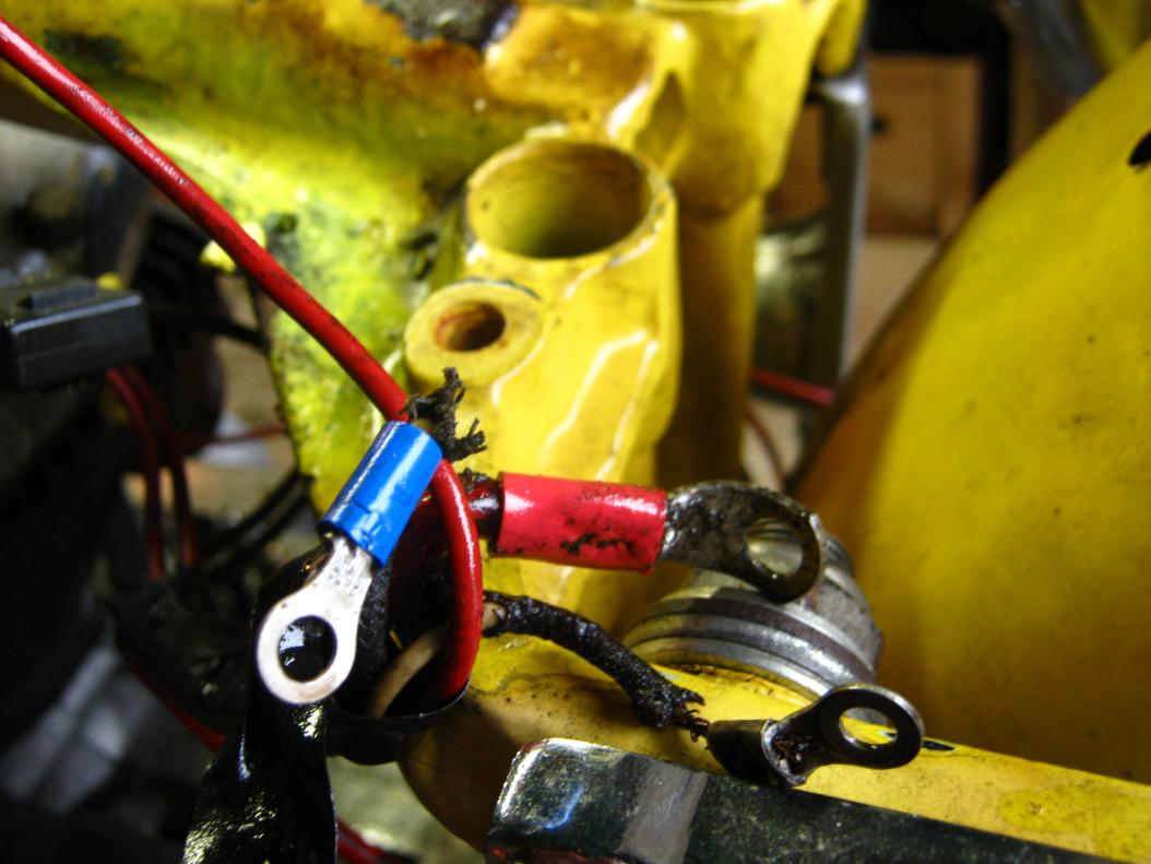

Default Lame Mechanics 101 & The Squat Gets Deep
OK, went into the clutch because the clutch pull was stiff. Adjusting mech was ok, so check the spring tension..Oh boy, The primary was full of engine oil, 3 qts., all of it. OK, I read about the ball check valve. I finally got the clutch cover ( which was glued on) off, and the clutch was full of tranny oil...fun, fun.
Now to lame mechanics. The cluch hub nut was screwed up because someone used a chisel on it. I had to use a mini-grinder to get the socket in shape to get a socket on it. After diassembling the clutch, there was not a single oil seal installed, and there was play in the mainshaft, so lets pull the transmission to replacethe oil seal and bearing there. Fun, fun, fun.
So, I decide to tear down further, since the frame needs welding.
As I go further the wiring is squat, the oil can and battery carrier were solid mounted so I need a new oil bag and the battery carrier broke a tab on the frame, oh, and instead of buying a lockwasher, weld the drive spocket to the shaft.
You gotta love these shade tree mechanics.
So, instead of doing a fixer-upper for the summer, I am doing the complete re-build.
Advice to Idiot Machanics. If you think you are smarter than the engineers who built the bike..Think Again.
Ol Yeller Mertie, will soon be Black Beautie
Ride Hard, Ride Free, and don't pick your Buggers in public
Attached Thumbnails Mertle Update-img_0221.jpg   Mertle Update-img_0216.jpg   Mertle Update-img_0219.jpg   Mertle Update-img_0220.jpg

Originally Posted by OlGrampy
... The primary was full of engine oil ... clutch cover ( which was glued on) ... clutch was full of tranny oil ... cluch hub nut was screwed up because someone used a chisel on it. ... clutch, there was not a single oil seal installed ... play in the mainshaft ... wiring is squat, ... oil can and battery carrier were solid mounted ... the battery carrier broke a tab on the frame ... weld the drive spocket to the shaft ...
This is brutal. Ya, bring that lady back to life. The world will then be a better place.
