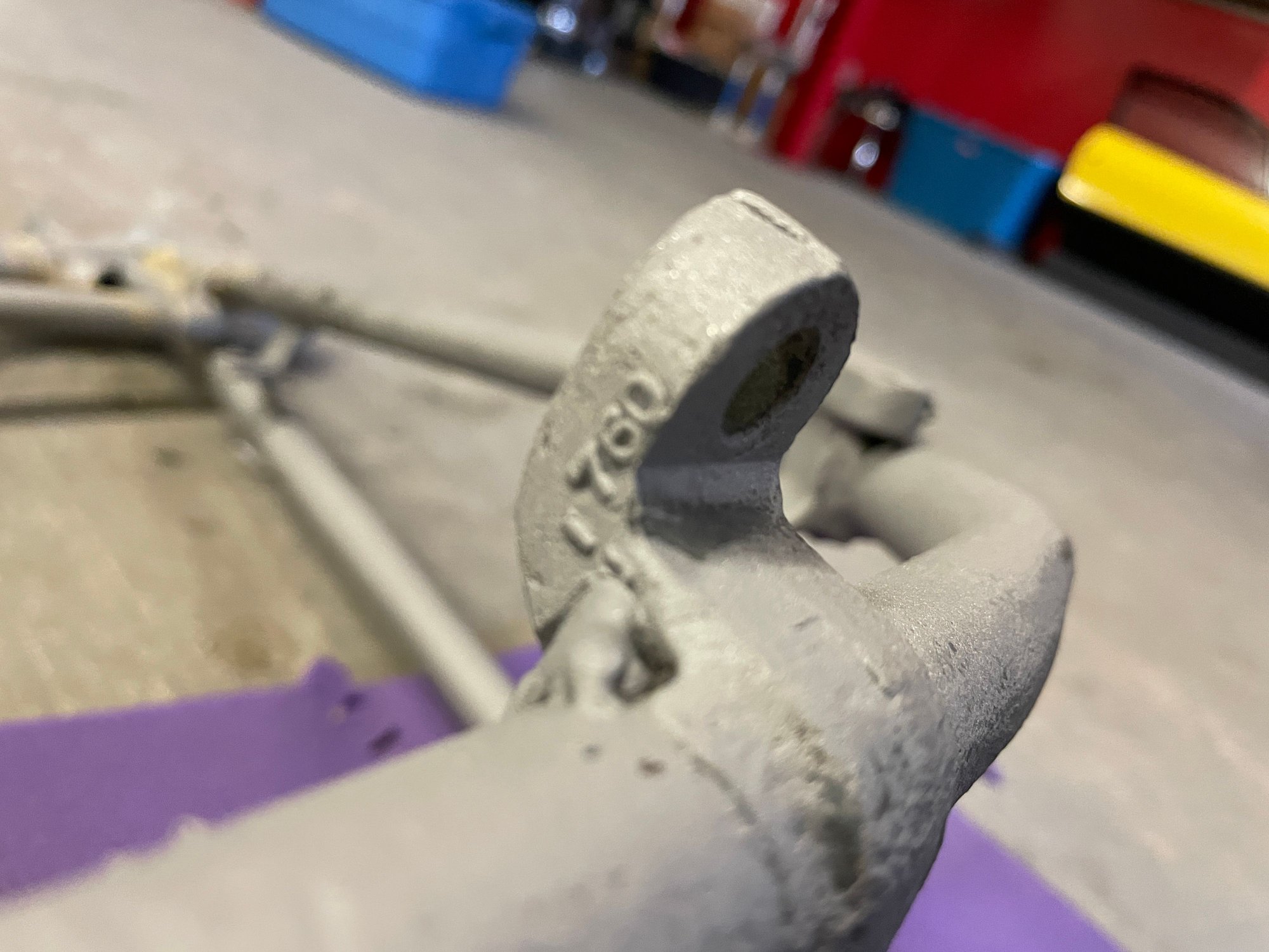

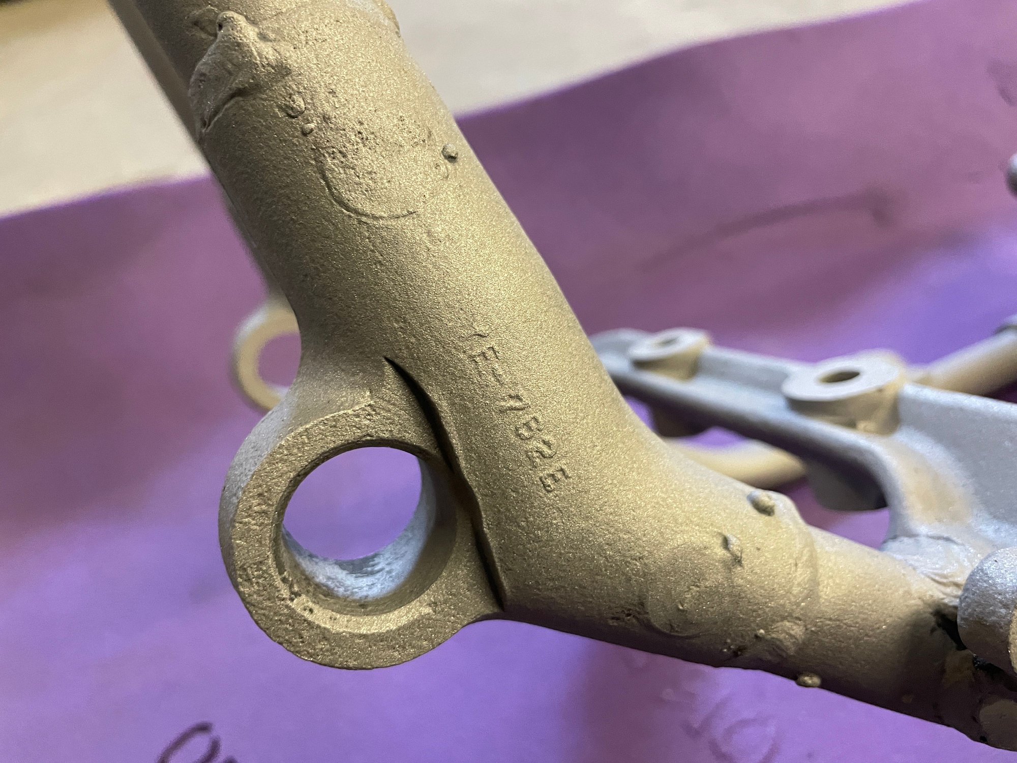

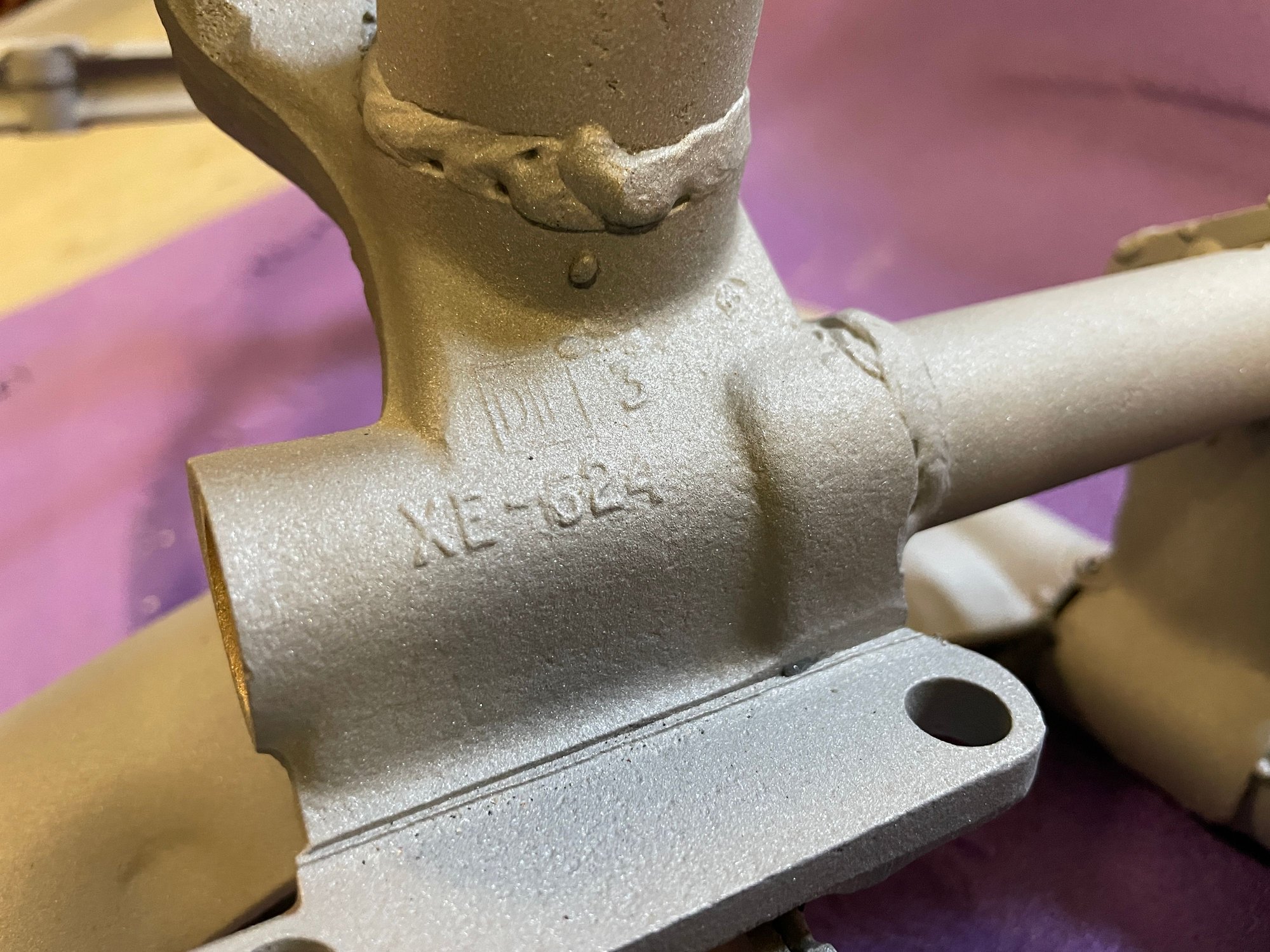

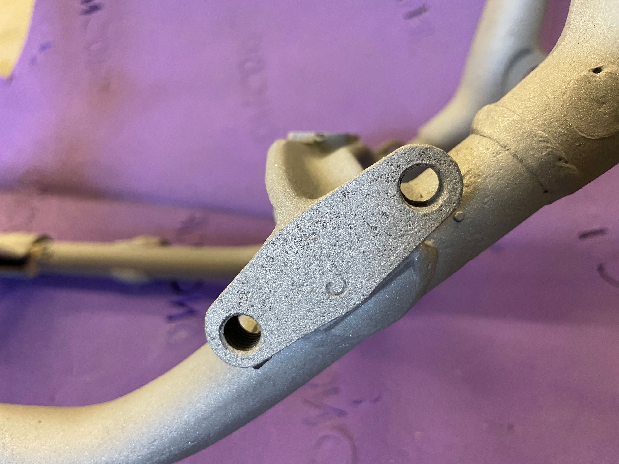

I think I did pretty good on the frame. Hasn't been sanitized, I think even the tool box bracket is original. What I didn't like was the quality of the paint the PO had done, lots of dirt and some lumps they painted over that I couldn't understand. With it stripped now I know, the furnace brazing was what those lumps were so I guess I'll leave that alone and not smooth them over. I was surprised how sloppy the brazing was, I figured they would sweat the joints and it would look like a solder joint on a pipe not like some kid slobbered all over it. I was also unsure of the tack welds on the axle clips and saddle joints behind the seat post but after seeing the furnace brazing over those tacks it must be original. Ive looked at some frames on line to compare and didn't see those tack welds. Maybe it was something done later in the run? No idea.
