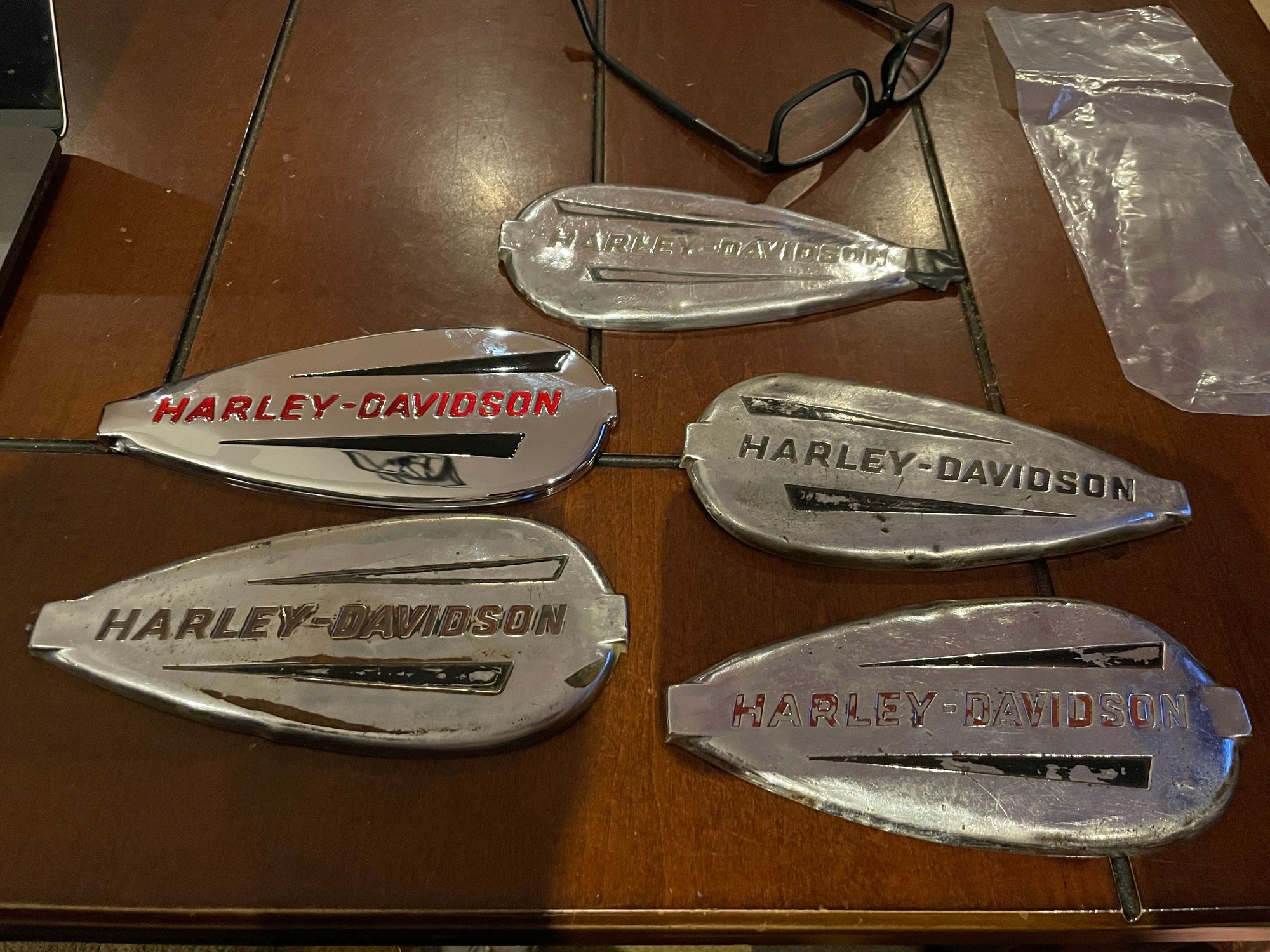

The frame is out for paint and Im dealing with the tank emblems now. Two will be painted for the 46 and two will be re-chromed for the 41 after I straighten them out. I haven't tried to fix something this small and detailed before but the prices I'm seeing for oem is inspiring me and I like the challenge.
I bought a repop emblem and from 15 feet away, maybe 20 it might pass for correct but they're really wrong up close.
Im not sure if its, the die is wrong, a lack of stamp pressure or the alloy doesn't agree with the what the die is asking of it but they didn't get the letting crisp. Looking at the back its very obvious (and the lack of the G in a circle). The repop is softer looking which also applies to the black arrows or whatever they're called. The other major issue is the lack of squared ends that connect to the saturn rings.
I saw some on ebay listed by a popular seller promoting them as oem but there's no circle G on the back and the lettering is rounded, wants $499 for one side and its really a $50 emblem.

It is amazing how bad the repops are for this item, they get all the money for OEM. It seems like it would be in someone's interest to make a really good copy, people would buy them for $200 a pair if they looked correct. Sucks you have to make them shiny, those are some nice original pieces. When I bought mine I got lucky, someone had painted the letters black and it kept a lot of people away from the auction. Pretty sure I paid less than $300 for a pair. Then with some mineral spirits, q-tips and patience, all the black came right off revealing the red paint underneath.
Sometimes you get lucky.

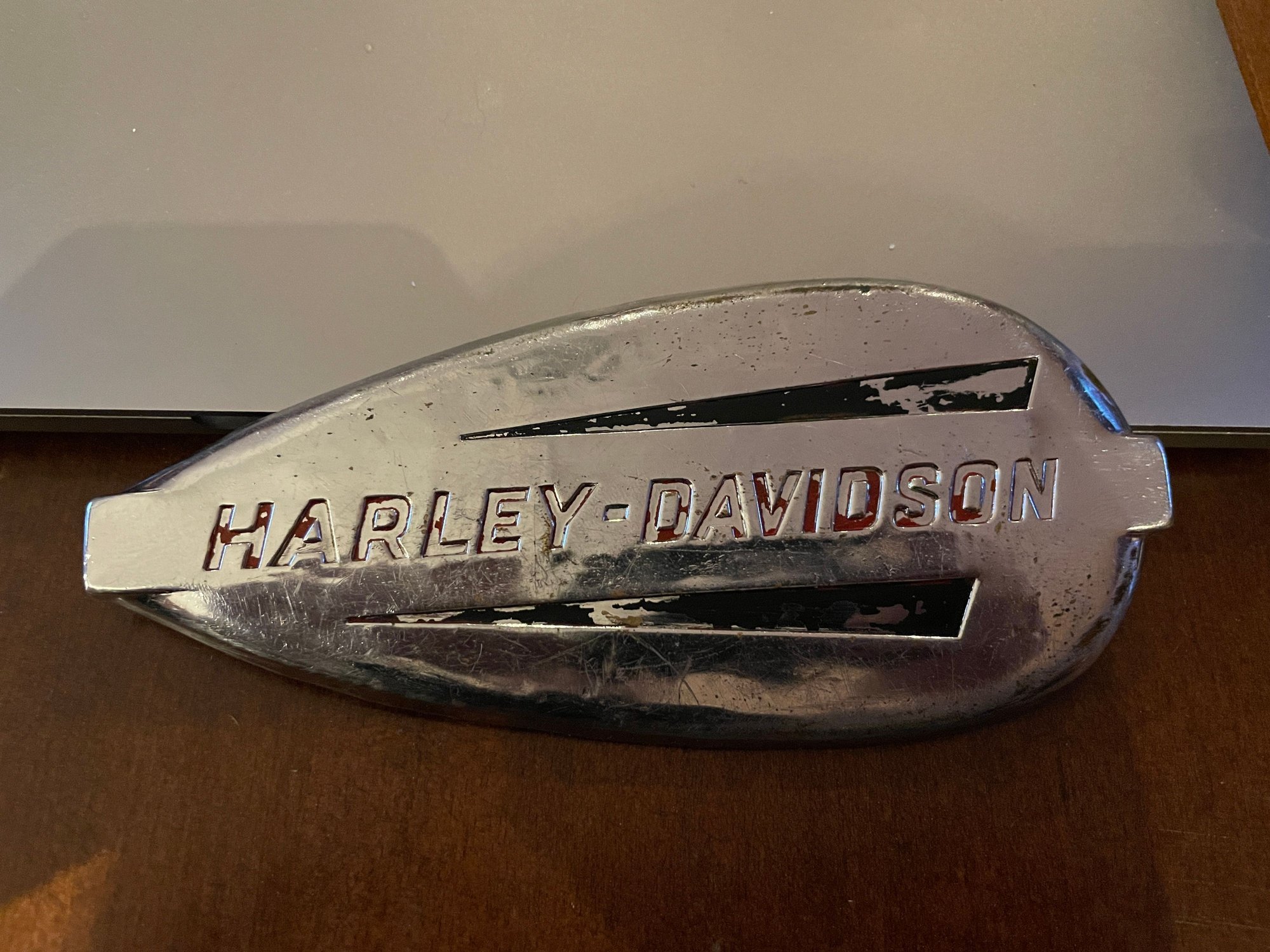

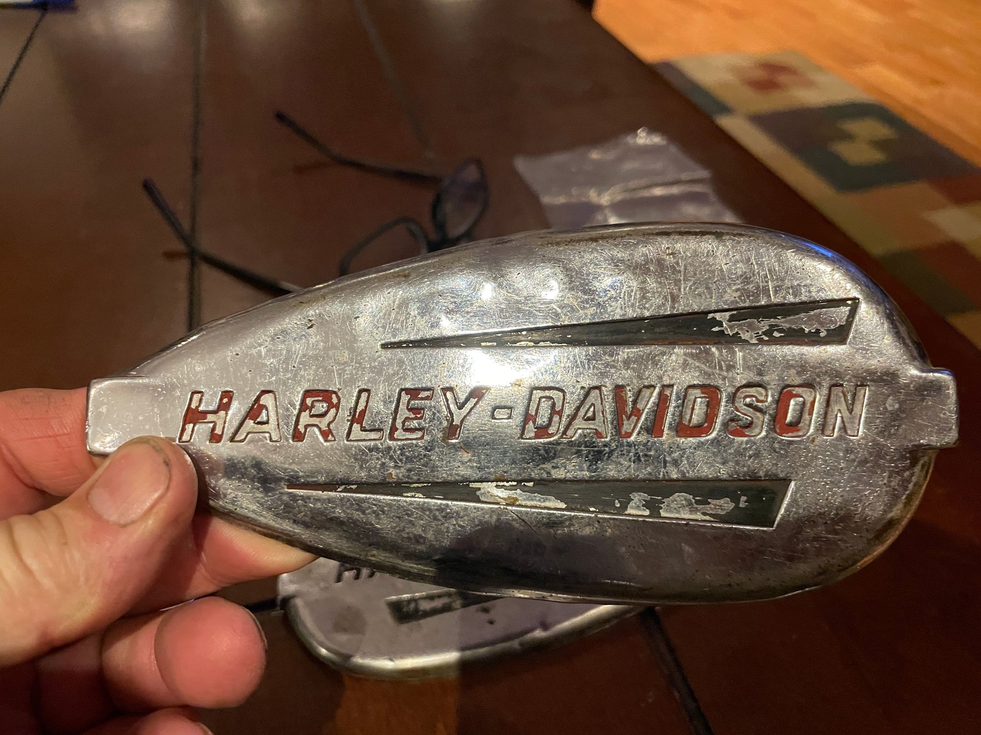

Before
After some attention, less dents. Had my fill for a friday night. Will continue to make it better then 3 more to go.
