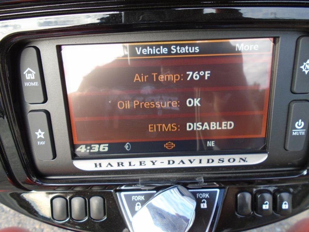

I'm wondering if the EITMS goes Active when the temp reaches 80+ degrees like the 2014+ fairing equipped models did. By any chance did you have the vehicle info screen on? On the 14+ when the temp hit 81 degrees the EITMS would activate when you stopped for a light. It was based on the ambient air temp sensor that is used to display air temp on the info screen and not on engine temp. Just curious as I'm still riding my 14 FLHTK.
Yes, I kept checking the info screen for air temp and that sounds exactly like what I'm experiencing - above 80 the EITMS seems to go on at every stop once engine is up to operating temp. Below 80 I haven't seen it activate

Did you take it to the dealer and have them reprogram the ECM to active the Oil Cooler Fan? It is required to make it work.

Thats correct 1st page of instillation below:
Functionality of this kit will require a verification that oil cooler fan control has been set to "ENABLED" in the
vehicle's electronic control module (ECM). This verification can ONLY be performed by a factorytrained
technician
at a HarleyDavidson
dealer, using the most recent version of the DIGITAL TECHNICIAN II computerbased
diagnostic software package.

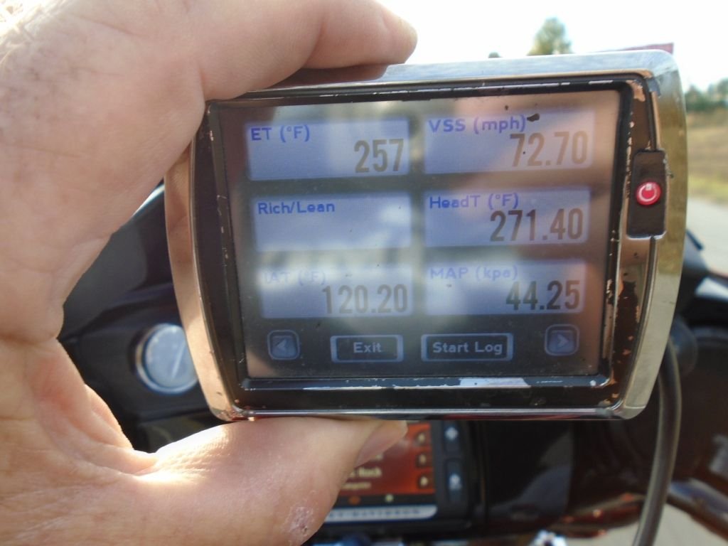

This may not be relevant to you guys, just something I did, and wanted to post results here. I have a 17 CVO Street Glide. I also have a power vision tuner that I hooked up on the bike. It's not married to the bike and I didn't tune it. I just used it to get the gauge readings. The readings are engine temp, mph, head temp, intake air temp, map. here are my readings, your results may differ...also, I am not sure where the pv gets these readings from...

Yea the dealer enabled the fan, been riding but temps have been in 70's fan doesn't come on temp on stick hasn't been higher than 220's last few rides
