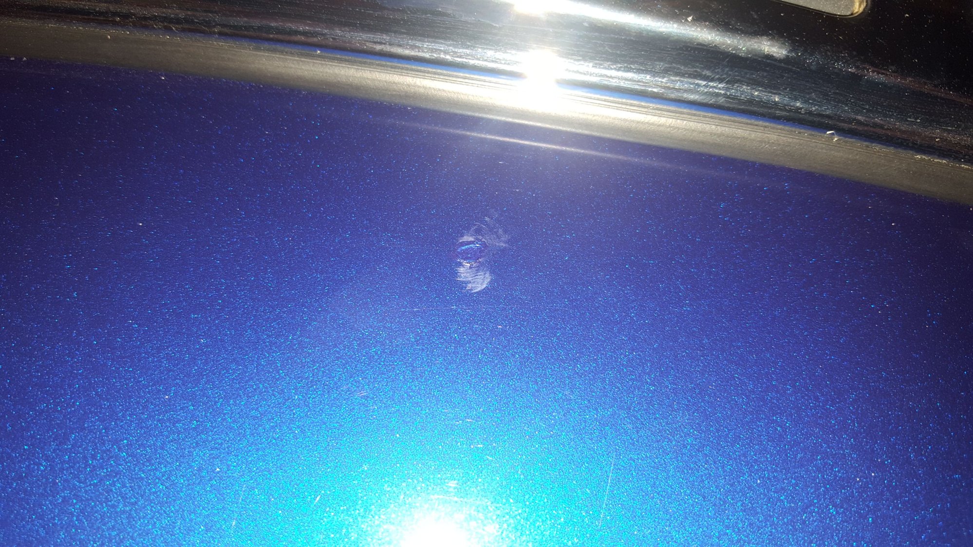

Default Work In Progress
Here are my touch ups in process. Sorry I don't have complete pics.
Tank chip from I-40. No vehicles to be seen for a mile or better in front of me. Big black rock coming twords me on the concrete. WTF!!!! Stay down you hunk of crap. Dash for the right shoulder and it stays with me, leaps up in the air over the windshield, hits me in the chest, drops to the tank,,,, PISSED!
Went to HD dealer. $38 for blue kit, $38 for silver kit and the clear coat is junk in both kits. But color match is great.
Trimmer string for reference.
FU FU Blue and Silver Paint job. Notice dark primer, Silver, Blue then Clear.
Cleaned area up with dawn soap and water. Then used 95% Isopropyl Alcohol. Then used 2k grit paper dry to key the chip up and soften the edges of the chip.
First coat of paint.
Second coat of paint.
Third coat of paint with first coat of clear.
Second coat of clear.
And this is where the problems begin. The clear coat always pops off. Does not matter if I use straight clear coat or mix with the paint. Use same basic prep as started with or don't touch it. Can get it wet/soap sanded down with 2k then 3k grit paper and polished out. Or not touch it. But in one to two weeks the clear pops off. The color match and how the flake lays out is great! But the clear is complete junk. So this weekend I hope to just build up the base coat, let it cure then level it out and polish it up.
Here is the left bag that got abused by a grandsons BMX bike and front wheel peg. I was going to have a shop that restores antique cars fix this. BUT it's not as bad as it looks.
I compounded and polished this out. The top scuff is gone. The edge of the bag lid is down to the abs and will need some basic trickery. But will come out real good with no clear coat needed. Just a build and profile. The deep scratch in the clear is a issue. It's only down to the paint in one very small area. But even after cleaning it up it looks like the grand canyon polished out on the side of the bag. And knowing the clear is junk in both my HD touch paint kits I'm going to have to find a more aggressive/acidic clear coat. With a aggressive clear i could lay the clear into the grand canyon, block it and polish it out and it would be completely gone.
The base paint is a great match! Near to the best I've ever seen. The flake even flips right. I have painted and detailed everything from thimble sized art work to airplanes. And I have never seen a manufactures touch up paint match as good as HD's when used right. But the clear coat sucks bad!
