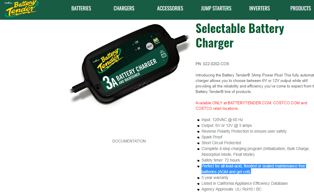

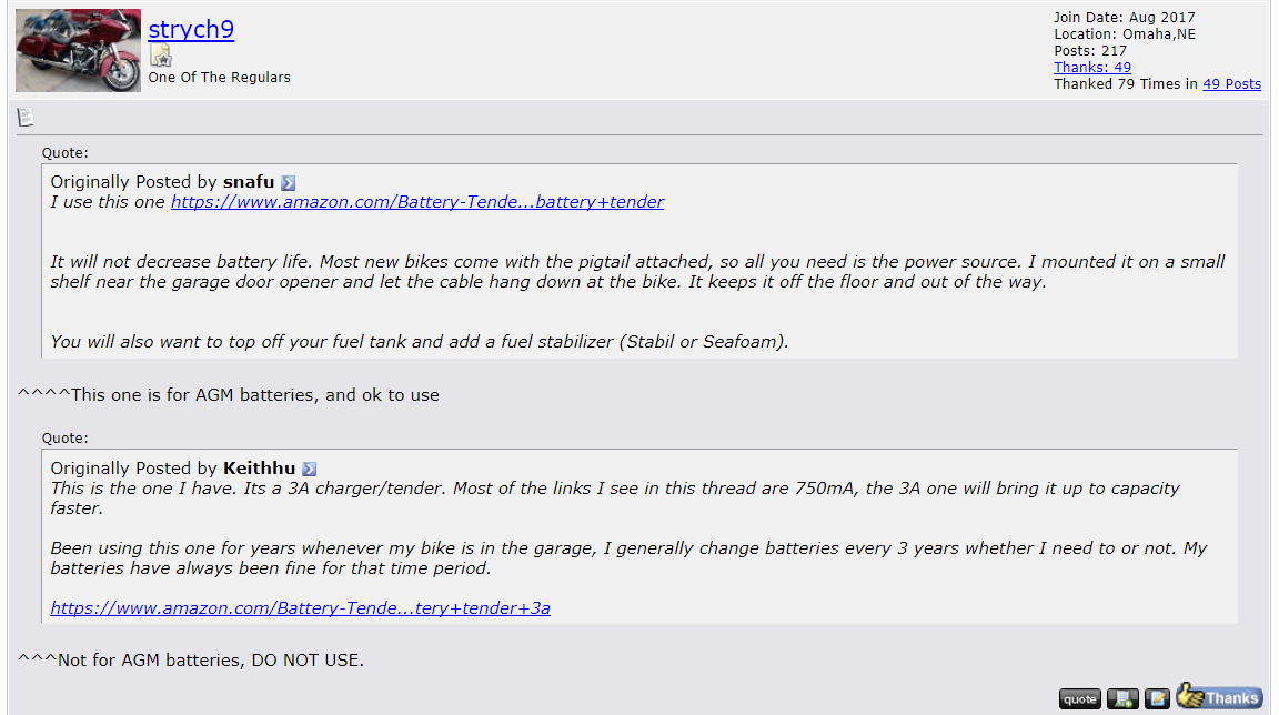

Quote:
I think this second unit referenced by Keithhu DOES WORK for AGM batteries:
Directly from Deltran's website:
