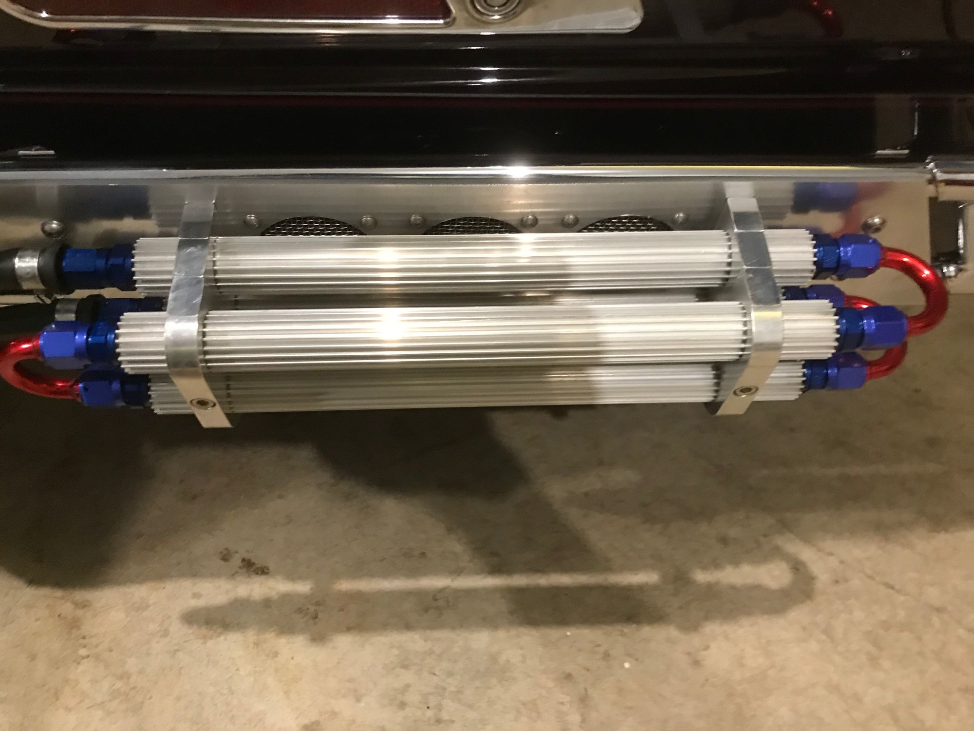

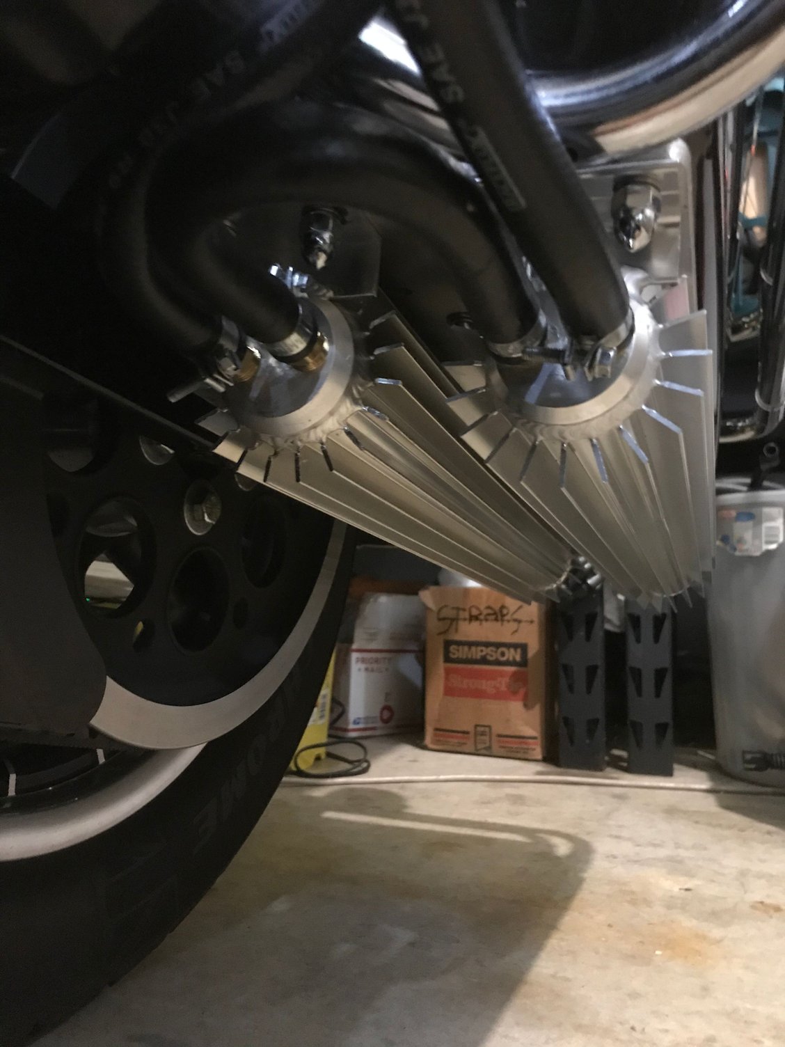

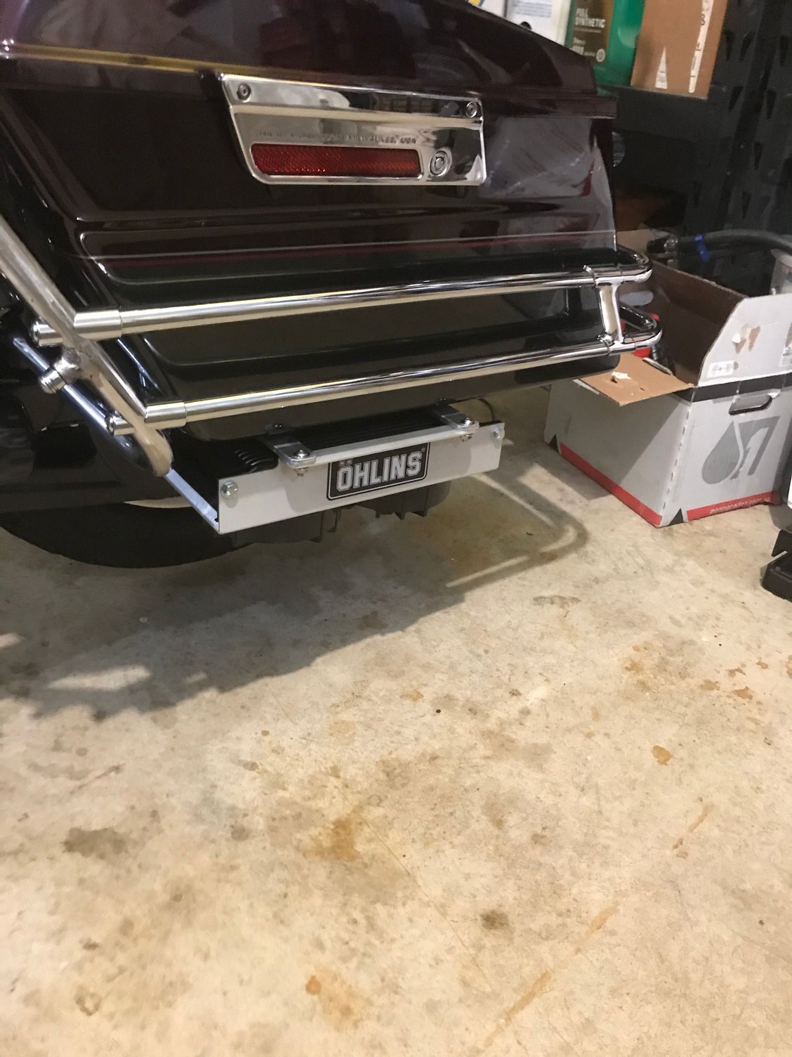

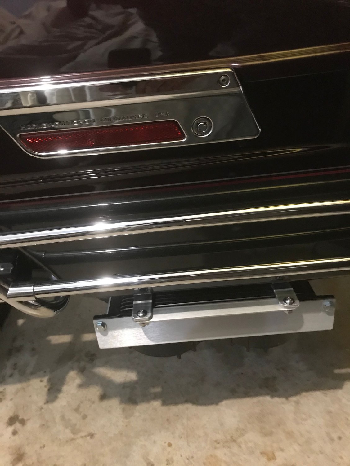

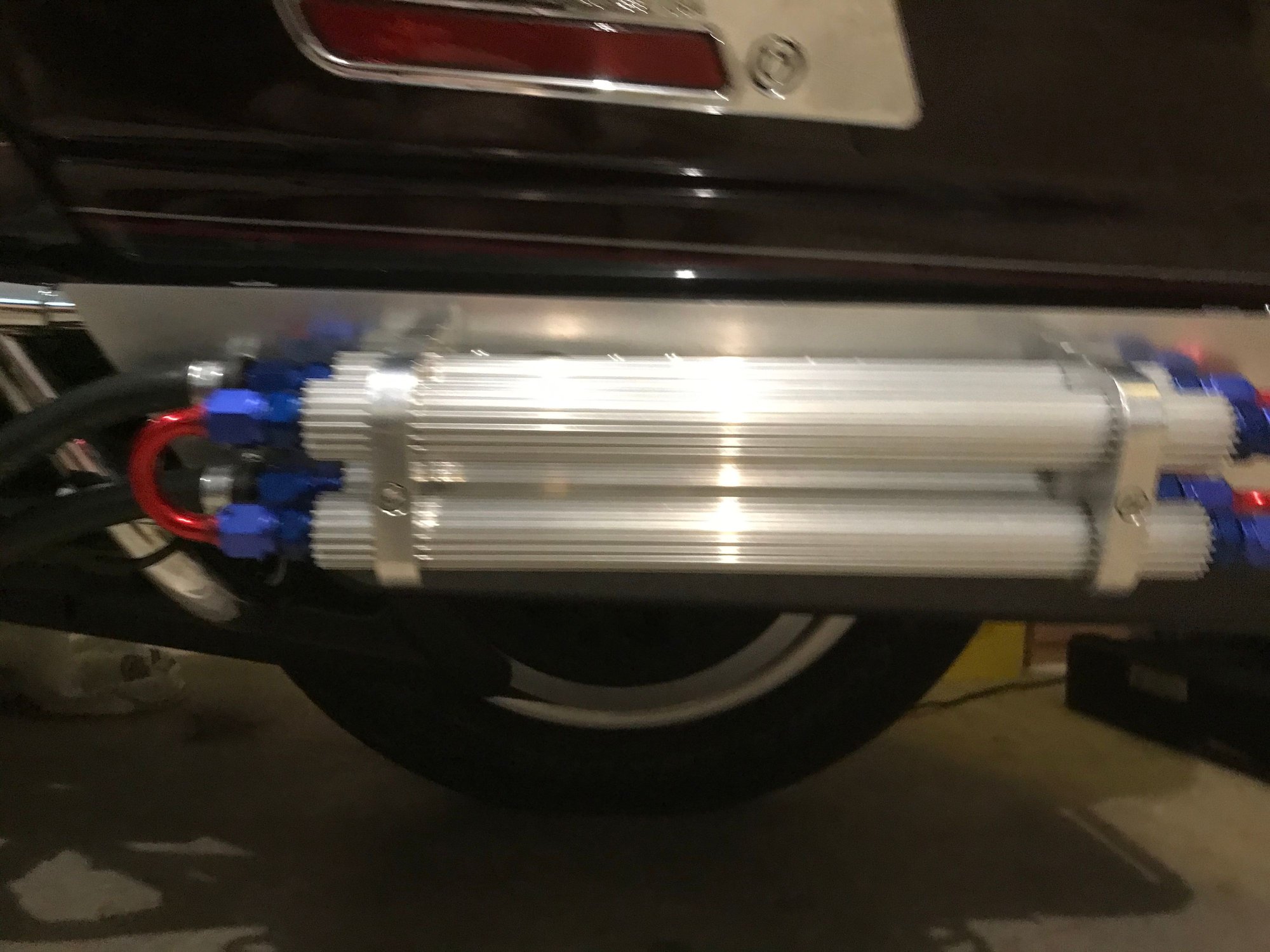

This is some out of the box oil coolers I have ran.
I have a few more but know pictures.
All these coolers are much larger than anything Harley, jagg, or Dk sells. If you believe those little wimpy oil coolers with fans are gonna help.
Go ahead a gettcha some.
Therm-Tex with three big sky fans behind it. Fans didn’t do crap to bring down temps.
Feral hyper cool 19 row cooler with two large fans. Again fans didn’t do anything.
The latest that works the best is two 20” Derale heat sinks without fans. Hold over qt 1/2 more oil. Still heats up at stop and go traffic. But recovers much sooner than the others.

That's a nice and dandy, but I'm not sticking a NASA Science project on the side of my ****in bike so...
I'll go with a fan that can be effectively hidden between the cylinder and radiator.
