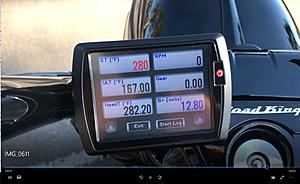

Breaking in new '18 RKS and I was surprised to see much higher temp engine and head temperatures on Road King Special. At one point engine temp read as high as 315F and head temp at 345F. Ambient temps this time of year here is about 85F.
I remember, my former '14 FLHTK Project Rushmore, would register as high as 250F engine temp and 300 head temp...
Looks like my oil cooled M8's is running much hotter than my wet head Rushmore...any else observes this same temps on your oil cooled M8s?
Also, the drive belt is so tight, almost no slack at all.

Yes, these are normal numbers... I have a twin cooled M8 and my head temp can go as high as 350+ on a 95 degree day and high rpm (riding it in the 40/5500 range) but they quickly come down in the lower rpm's Yes they run hot... if you see 400+ temps, be concerned

Looks good to me. Have your dealer check drive belt slack.

I just got a twin-cooled Ultra Limited a couple weeks ago. A few days ago we had a 105+ degree day here in Southern California. I checked some temperatures (cylinder heads, cylinders, crankcase, oil pan, trans housing, coolant lines) immediately at the end of that ride with an infrared thermometer and didn't see anything over 260 degrees.

I too see those numbers here in South Texas. I have been considering going to a different air cleaner to try t get my IATs down. When the charge air is already 150F the motor can’t help but heat up. Wondering if anyone with a heavy breather / Hog snout AC may help with IATs better than the high flow which seems to pick up heat by being closer to the engine?
