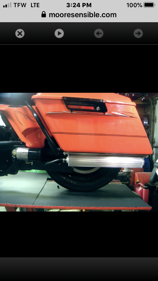

Originally Posted by buell95
This is some out of the box oil coolers I have ran.
I have a few more but know pictures.
All these coolers are much larger than anything Harley, jagg, or Dk sells. If you believe those little wimpy oil coolers with fans are gonna help.
Go ahead a gettcha some.
Therm-Tex with three big sky fans behind it. Fans didn’t do crap to bring down temps.
Feral hyper cool 19 row cooler with two large fans. Again fans didn’t do anything.
The latest that works the best is two 20” Derale heat sinks without fans. Hold over qt 1/2 more oil. Still heats up at stop and go traffic. But recovers much sooner than the others.
If you even needed something this ridiculous, something very, very wrong!

Originally Posted by jake24lt
When did they start making Flux capacitors for Harley s? That there, is some ugly *** repugnant *****! The added extra weight and drag would probably increase the engine load/oil temps alone! Never lost and engine due to heat, so I think I am OK with my FAN mounted cooler.
They have been around for years.
Dan Moore made them and did all the testing.
