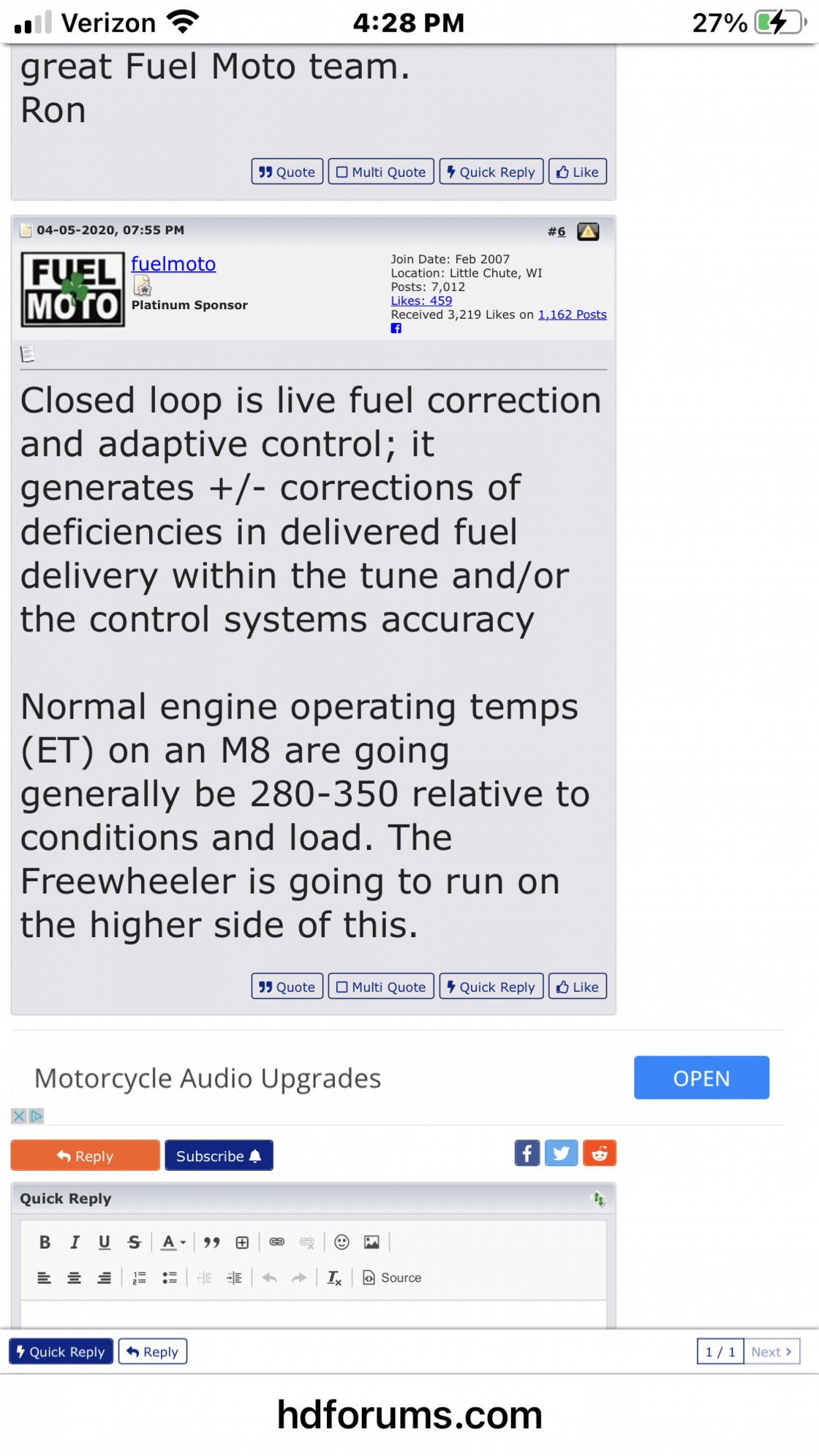

I trust this from them. I run at or just under e.t 300 ( ( power vision gauge)with a 114 with the 22xE cam and fuel moto’s map. This is in the dead of summer in ct. no worries! I believe the highest et temp I have noticed was 315 et.
Ahh, what I wouldn’t give for Northeast summers…
