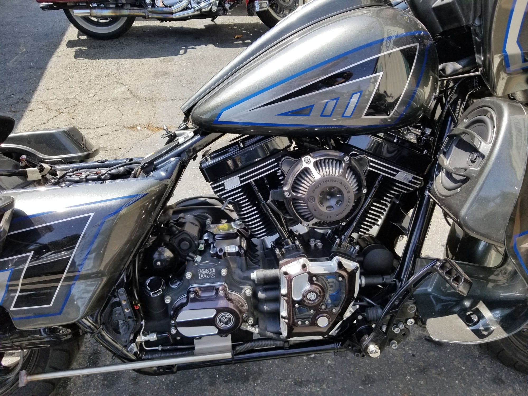

That a pre 2016 bike not a Milwaukee I take it that monster of a engine is in..What are the specs on that bad boy
