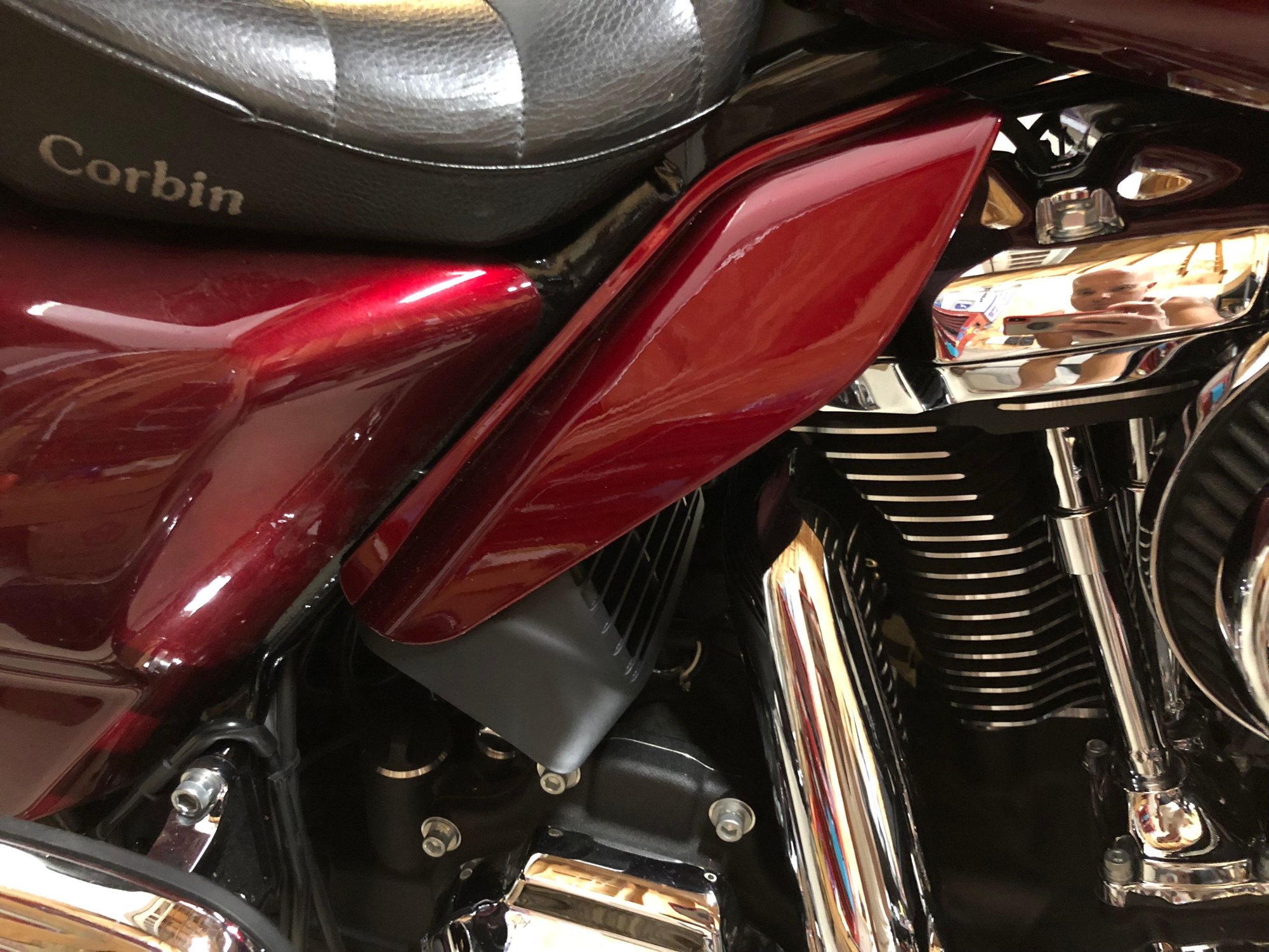

Installed mine tonight and managed to get it done with a full size mid-frame deflector. We'll see how that works long term. Need to go get it activated soon.
does it interfere with trans and oil dipsticks as bad as it appears it would?
It's no worse than when running the mid-frame deflectors. Just looks bad in pics.
