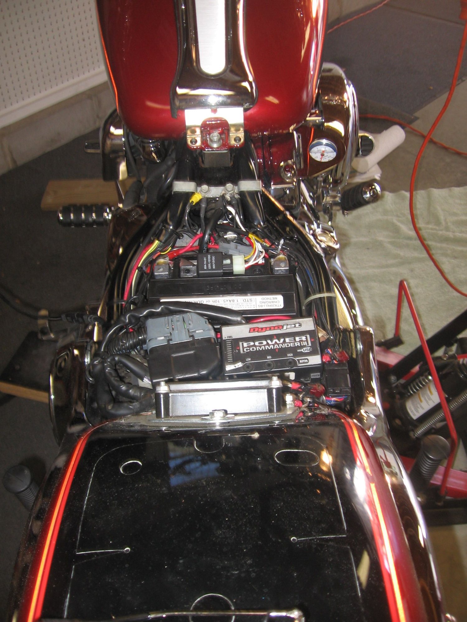

You may be referring to the Dyno Jet Power Commander. It's a separate 'box' that is installed on the bike and does not flash the stock ECM. It plugs into the harness between the ECM and the engine, and tunes the output from the ECM. You can remove it and the bike is back to stock.
