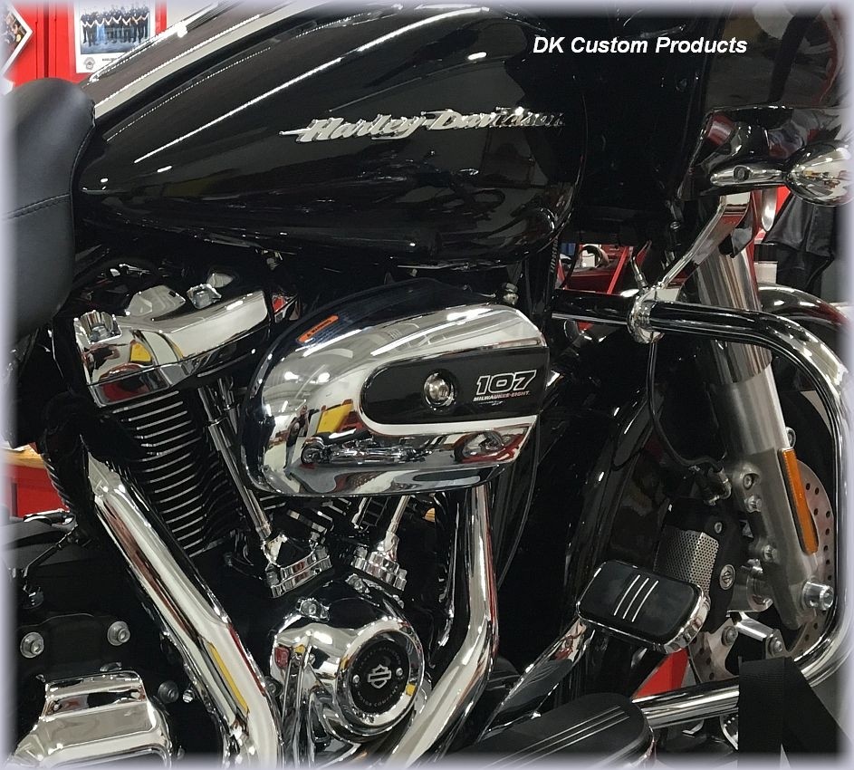

Another option to not only having a High Flow Filter, but also not feed that hot, oily, oxygen depleted air into the intake, AND keeping the stock cover, is the 606 HiFlow set-up.
Results in better performance AND better engine longevity.
