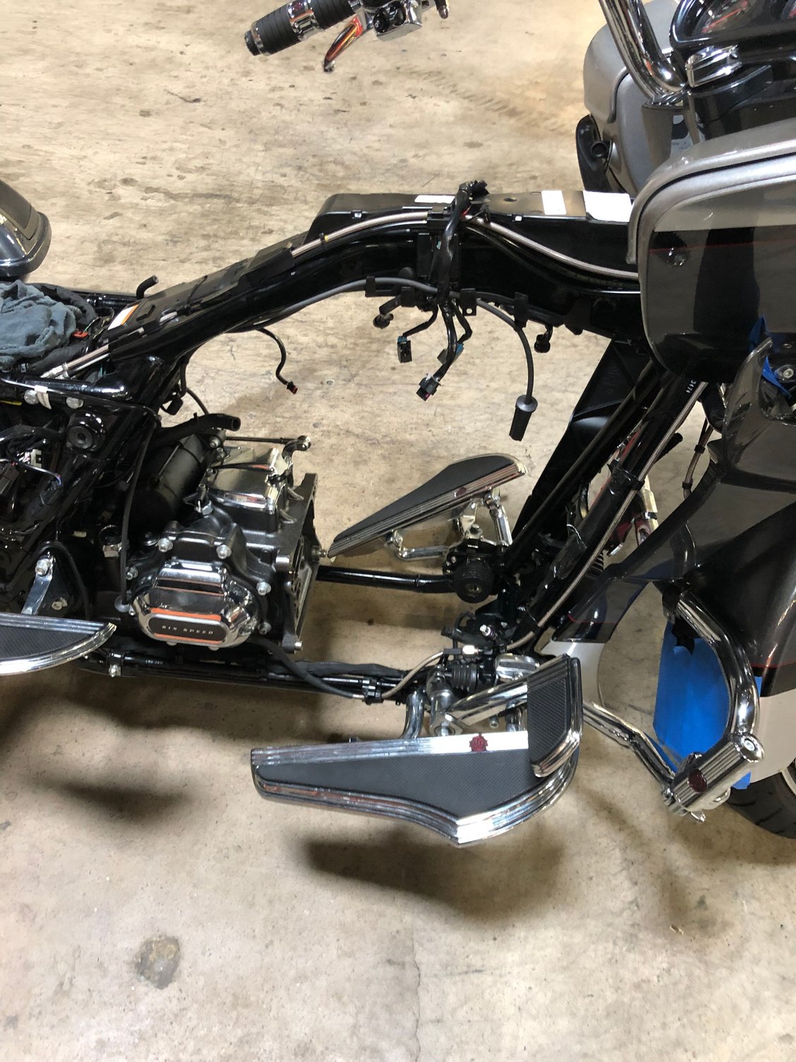

Default M8s Sump
I bought 2017 RGS had them install Stage 3 as the Stage 4 and not been made available in late 2016.
107 to 114 Stage 3 SUMPED
The bike sumped a few times and MOCO offered to pay to upgrade to Stage 4 if I paid for kit.
Being a power junkie I paid for Stage 4 kit and they installed.
This build SUMPED
Sumped 3 times and MOCO took it apart had lead tech from MOCO (Warren) come and mess with it.
They ended up installing new motor and new Stage 4 kit, guess what,
it SUMPED too.
I learned to keep a quart of oil with me and when it sumped just remove crank sensor, let oil out and top off.
2 years goes bye and the CVO was looking attractive.
So I asked dealer, did they fix sumping issue, of course they said oh yeah. New 5th Generation oil pump and Cam Plate with seal. It’s definitely fixed. So I traded the 2017 for the 2019 RG with 117.
Im thinking thank god im out from underneath that other POS.
Well 160 miles into break in.
117 SUMPED, (dealer said a ring broke and a piece got stuck in o pump) it damaged the cylinder so the MOCO was going to replace topend under warranty.
“since I was told it sumped due to broken parts I was still under assumption that M8 sumping was a thing of the past.
I bought Stage 4 kit and got it installed for free (because warranty was rebuilding topend anyway)
It has SUMPED 4 times and the compensator failed too but we are talking about sumping.
Dealer put me on demo bike, a stock 114 and it was doing great for 2 weeks, but hey it’s an M8 and you know
It SUMPED.
The moral of this post.
SUMPING IS NOT AND ISOLATED ISSUE.
ITS AN M8 ISSUE
DO NOT BUY.
unless of course only your speed limit obeying grandmother plans on riding the bike.
PS the bike is still in shop getting new motor and Stage 4 kit over 3 weeks now
50 Thousand Dollars
The M8 Sump hole
