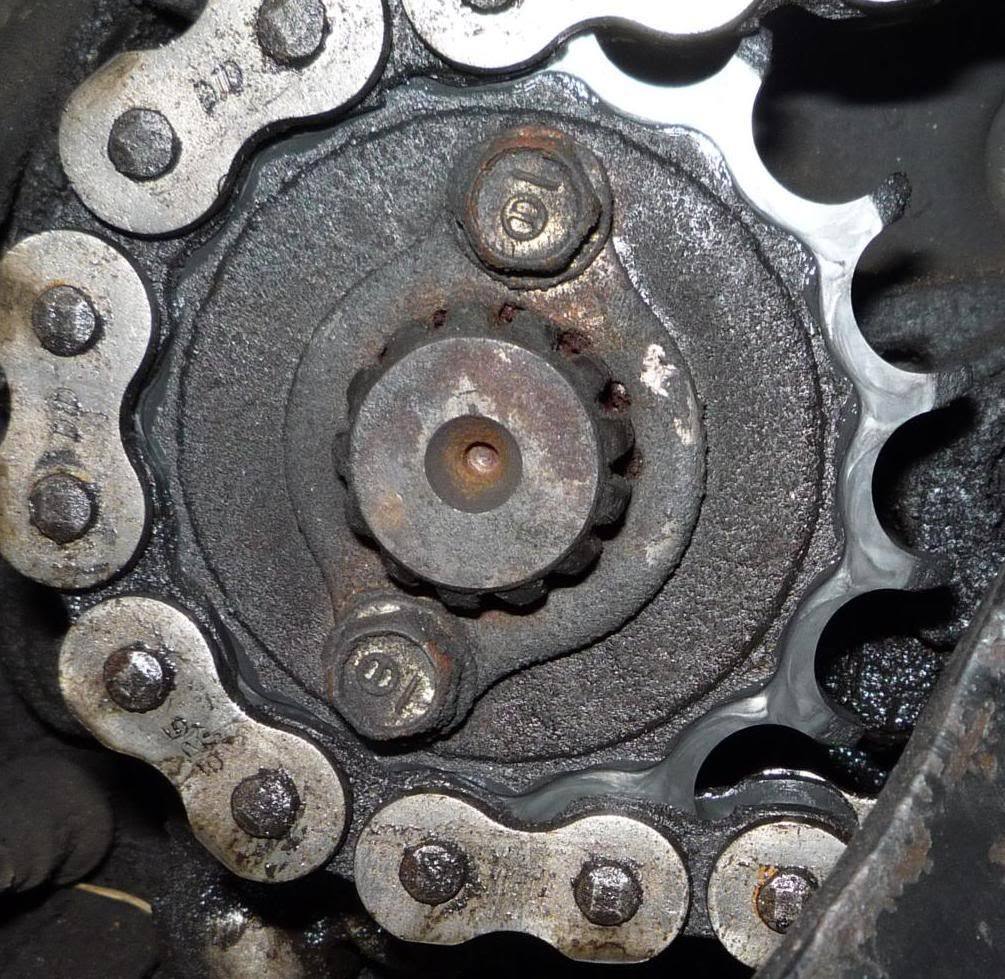

Depends how loose. Very loose primary chains can take lumps out of the inside of the primary chain cases. Ordinary everyday loose chains cause the teeth on the drive sprocket and clutch drum to wear into a 'hook' shape. Loose chains wear sprockets out prematurely, worn sprockets wear out chains faster.
