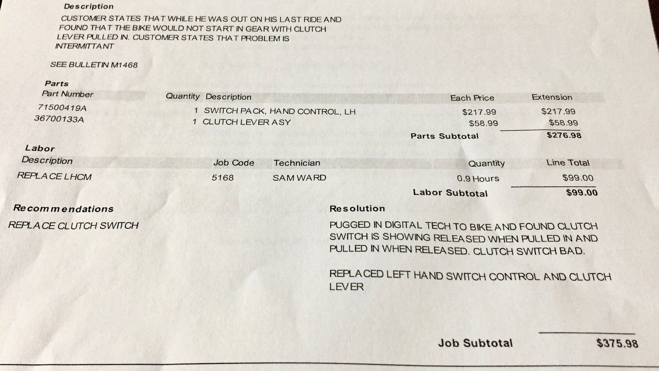

Service can identify the error with Digital Technician provided it's failing at that moment..hope this helps, and apparently the lever matters too..I noticed all the new bikes on the floor have the new switch like this one I got
