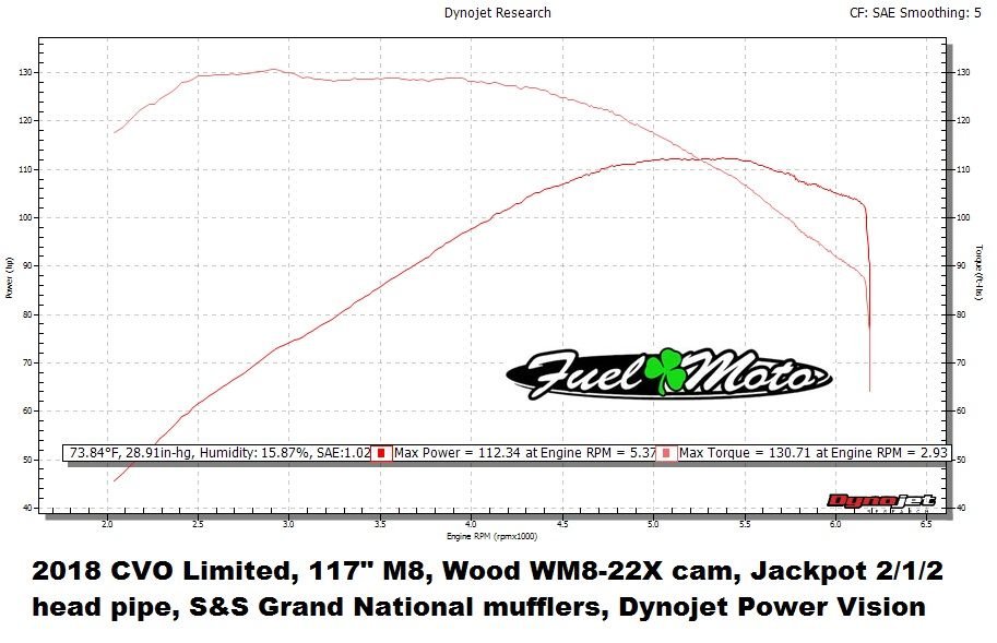

The 22x should be able to support 11.1:1 compression pretty easily. This is a FuelMoto has a dyno sheet of a 117” CVO with the 22x installed. It has 10.5:1 compression stock, I think additional compression will make additional power.
